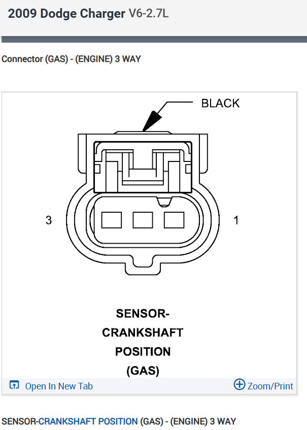

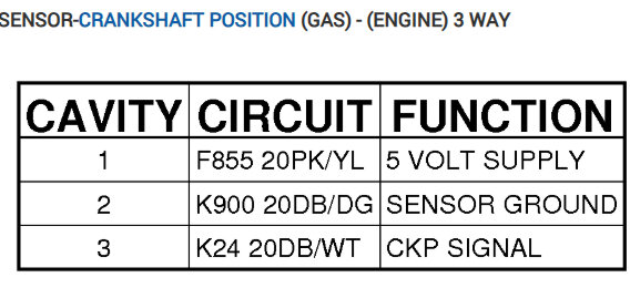

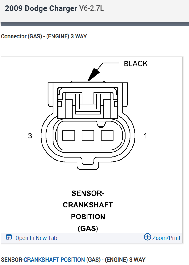

Crankshaft position sensor wire diagram?
2009 DODGE CHARGER
240,670 MILES • 2.7L • 6 CYL • 2WD • AUTOMATIC
LEO KASPER SANDOVAL
Connection to the crankshaft position sensor got pulled out and I'm not sure what wires go to what pins is it three pin one is yellow second one is dark blue and white, and the third one is a light green.
Jun 28, 2025 at 6:01 AM
  • 55,433 POSTS
Sure, here is the crankshaft sensor connector and wiring assessments. Check out the images (below). Let us know if you need anything else. Yellow, dark green and white wires.
