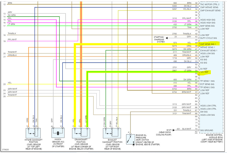

I need help with getting the Crankshaft position sensor wire diagram.

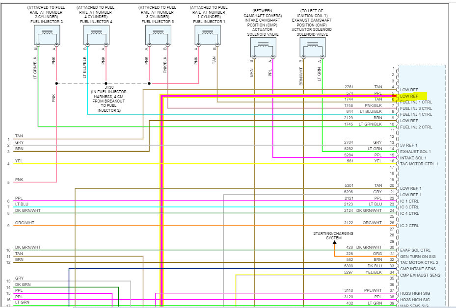

I attached the wiring schematic for the sensor. Also, I highlighted the wiring from it and where it goes to. Note that all three sensor wires go to the engine control module (ECM) which is located near the battery.
Additionally, I had to cut the pic in half to make it readable. I did overlap it so you can follow from one to the next.
Let me know if this helps or if there is anything I can do to help.
