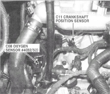

Where is the crankshaft position sensor located on a 06 kia Sedona LX located tell me step by step please

The 2006 Kia Sedona's crankshaft position (CKP) sensor is typically located on the front of the engine, near the crankshaft pulley or flywheel.

The crankshaft sensor is bolted to the rear lower side of the engine block, right where the engine meets the transmission. Check out the images (below). Let us know if you need anything else.
