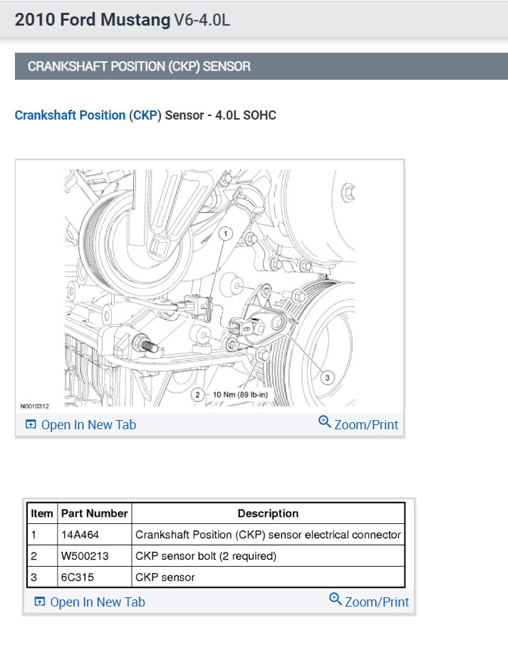

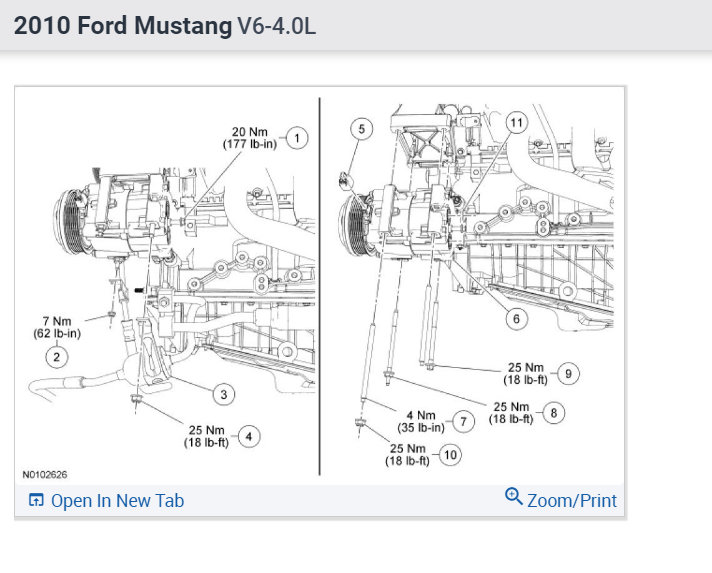

Do I have to drop the A/C motor to get to the crankshaft position sensor?
2010 FORD MUSTANG
181,000 MILES • 4.0L • 6 CYL • 2WD • AUTOMATIC
NADINE KETTERER
Do I have to drop the A/C motor to get to the crankshaft position sensor on this year Mustang? Haynes manual doesn't mention it, but forums do. Also do I access it from under the car?
Aug 29, 2022 at 3:03 AM
  • 55,420 POSTS
No, you do not need to remove the A/C compressor because it is on the opposite side of the engine. here is the location of the crankshaft position sensor and the A/C compressor so you can see for yourself. Check out the diagrams (below). Please let us know if you need anything else to get the problem fixed.
