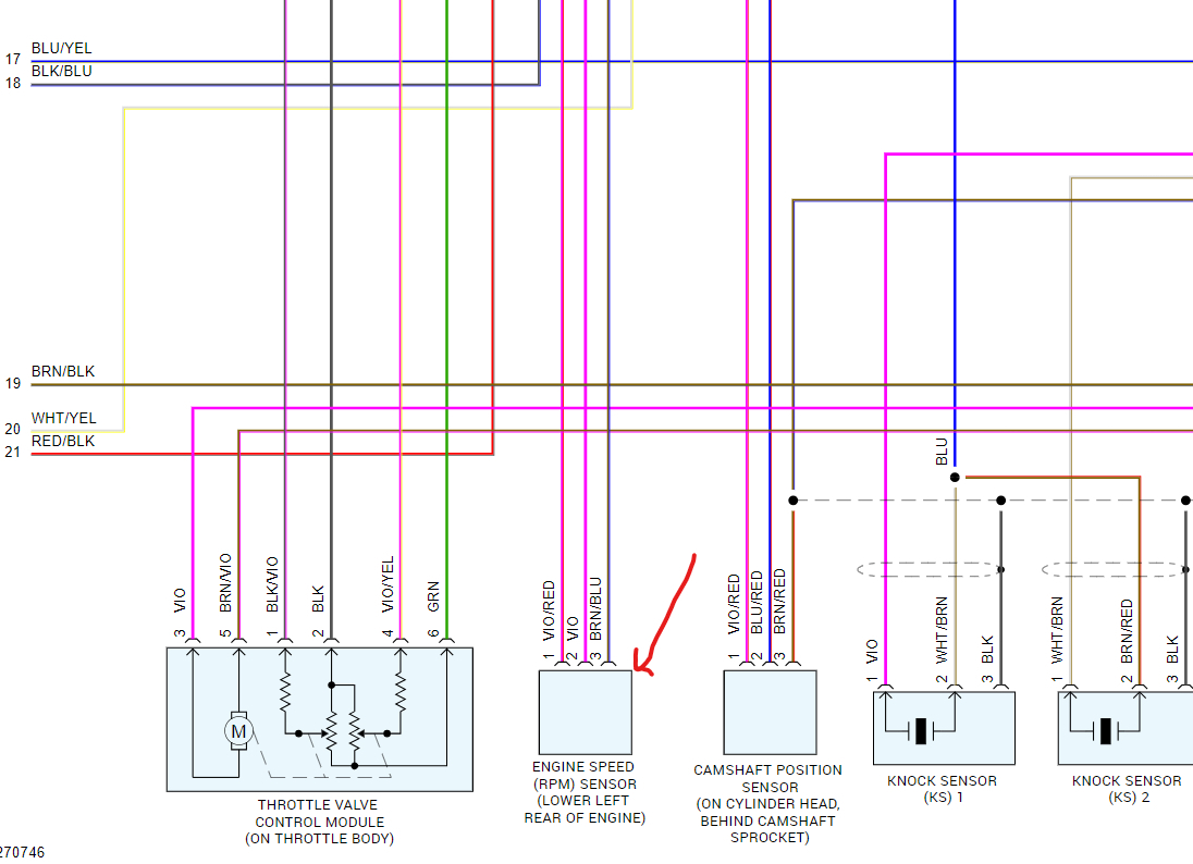

When I was replacing the crank position sensor on my daughter's car listed above, the wires came out of the plug on the wiring harness side. I'm looking for a wiring diagram that shows what color wire goes to which pin location on the harness so I can re-pin the plug and get her car back on the road. Thanks!

They call it an engine speed sensor and they only have the wiring diagrams which show you how they go into the connector by location number. Check out the images (below). Let us know if you need anything else.

Thanks Ken! This is the exact information I was looking for.

RICKTBOW
Re-pinned the connector and her car is back up and running again. Thank you!
