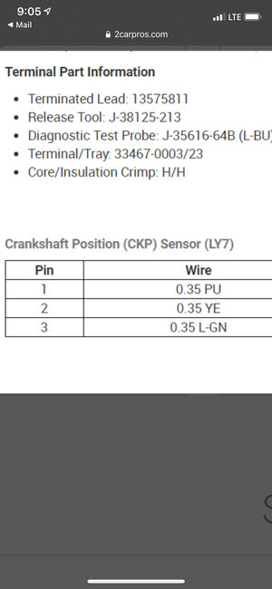

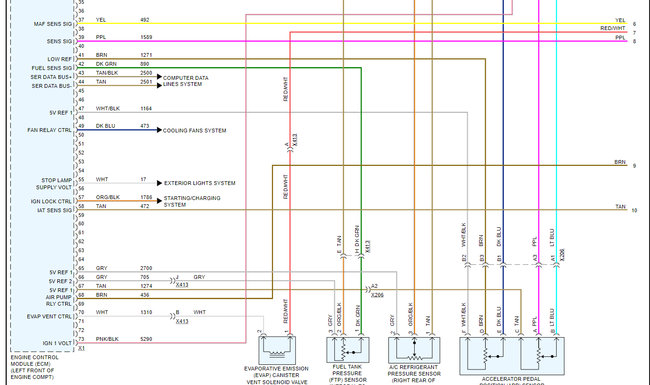

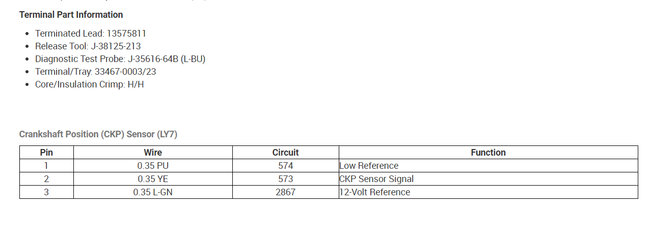

Need help knowing which colored wires connect to the new connector.
Wires accidentally got ripped out during removal of crankshaft position sensor. I bought the replacement and all the wires are white.
It is a three wire setup. Purple, green and yellow.
Thanks

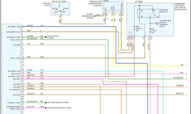

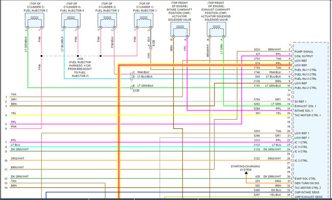

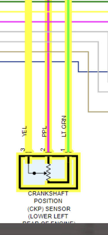

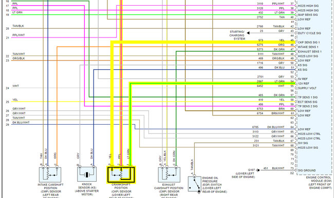

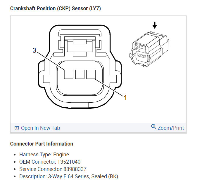

I attached the connector diagram and the wiring diagram for you to view.

I see where the attachments contradict each other... one says that pin one is purple and pin 2 is yellow. The other says that pin 1 is light green and pin 2 is purple.
Thank you for the answer, but please clarify this for me.
May 15, 2021 at 11:13 PM
Sorry for that. Go with the diagram highlighted in yellow.
