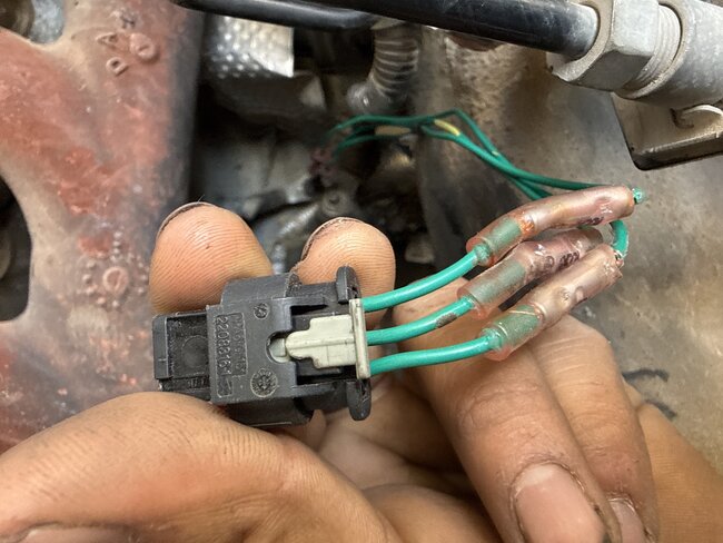

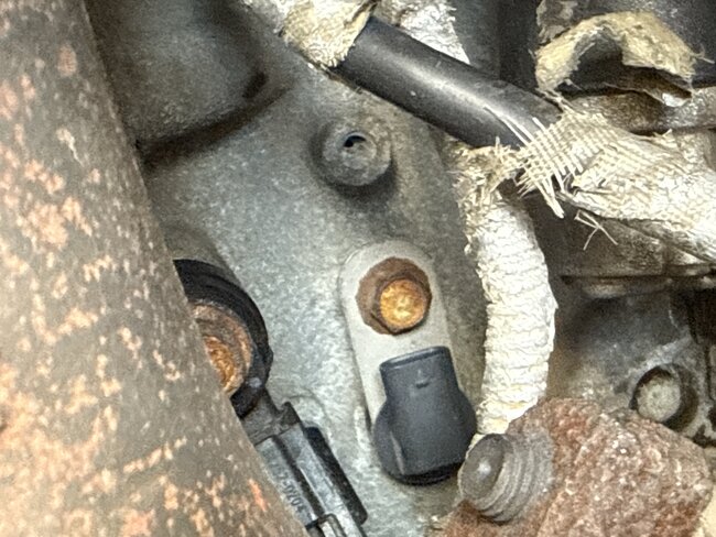

Crankshaft position sensor pigtail?
260,000 MILES • 5.3L • 4WD • AUTOMATIC
RAFASL
3 wire pigtail
Purple/light blue
Black/ purple
Green
Not sure were these go from the back with clip up I have left to right
Green purple and blue then black and purple

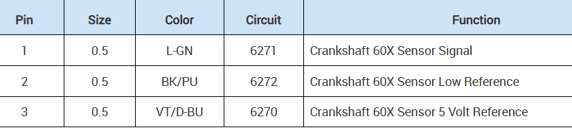

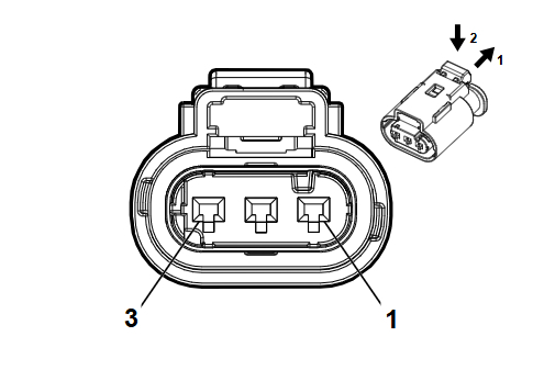

Yep, you need the connector view for the crankshaft sensor. Check out the images (below). Let us know if you need anything else.
