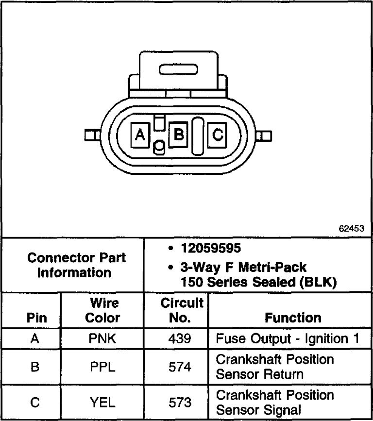

My crankshaft position sensor connector broke off i bought a pigtail but, all the wires are white I have no idea how to reconnect to my original-colored wires it's a 3-wire connector.

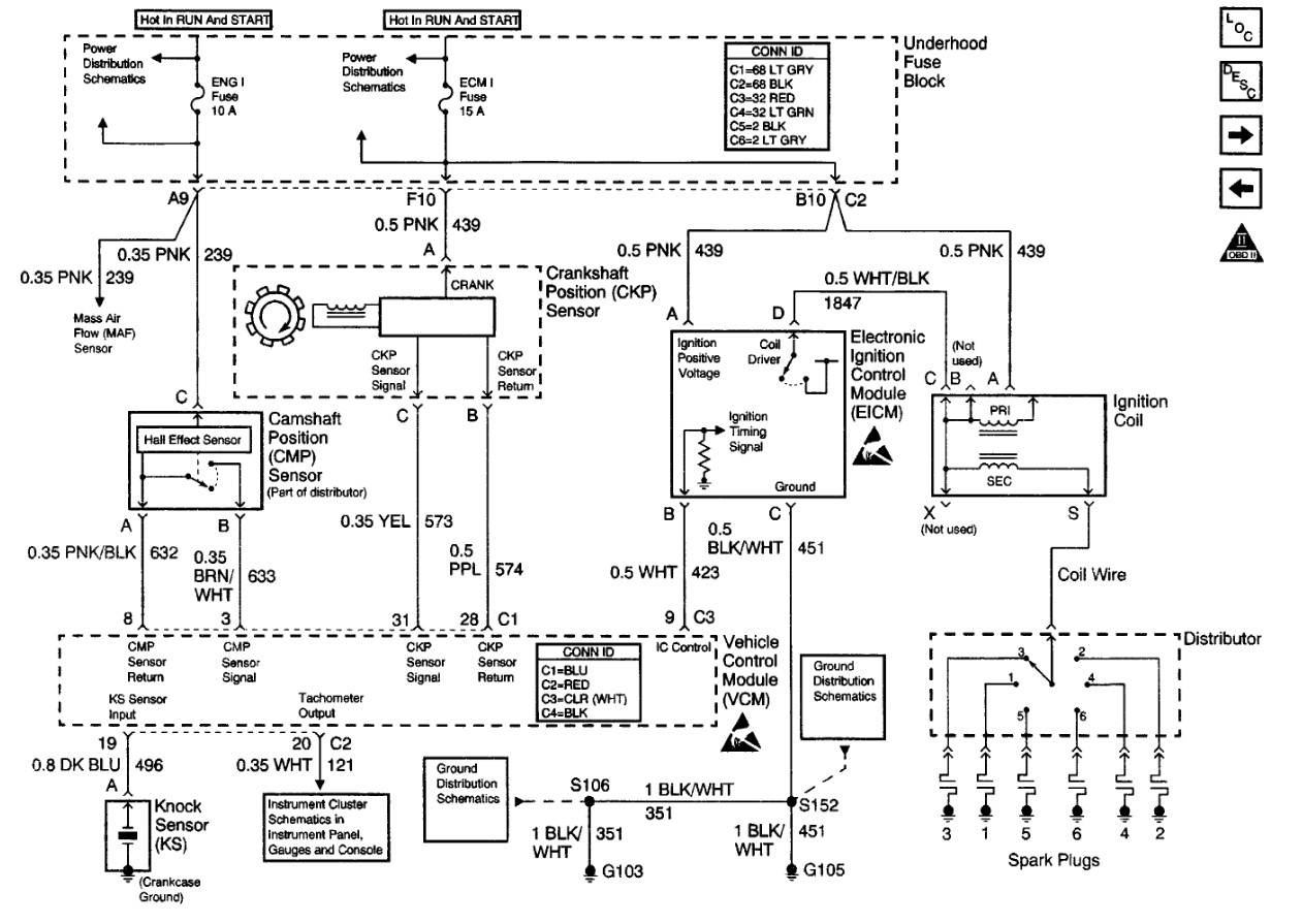

That is done so that they can use that same connector for anything that requires 3 pins. In your case the three colors are Pink with a 12-volt feed on pin A, then a Purple that is a ground into the ECM on pin B, and lastly a yellow wire that is the sensor signal. The connector image is looking into the connector with it unplugged. The connections there need to be good. I use individual non-insulated crimp connectors and adhesive lined heat shrink normally like in this video:

Both work well as long as you don't damage the insulation.

Awesome, thank you. another thing my new connector doesn't have ABC on it so how would i know where to start?

Hold up the connector so you can look into the face of it like the attached picture above, that shows you ABC.
