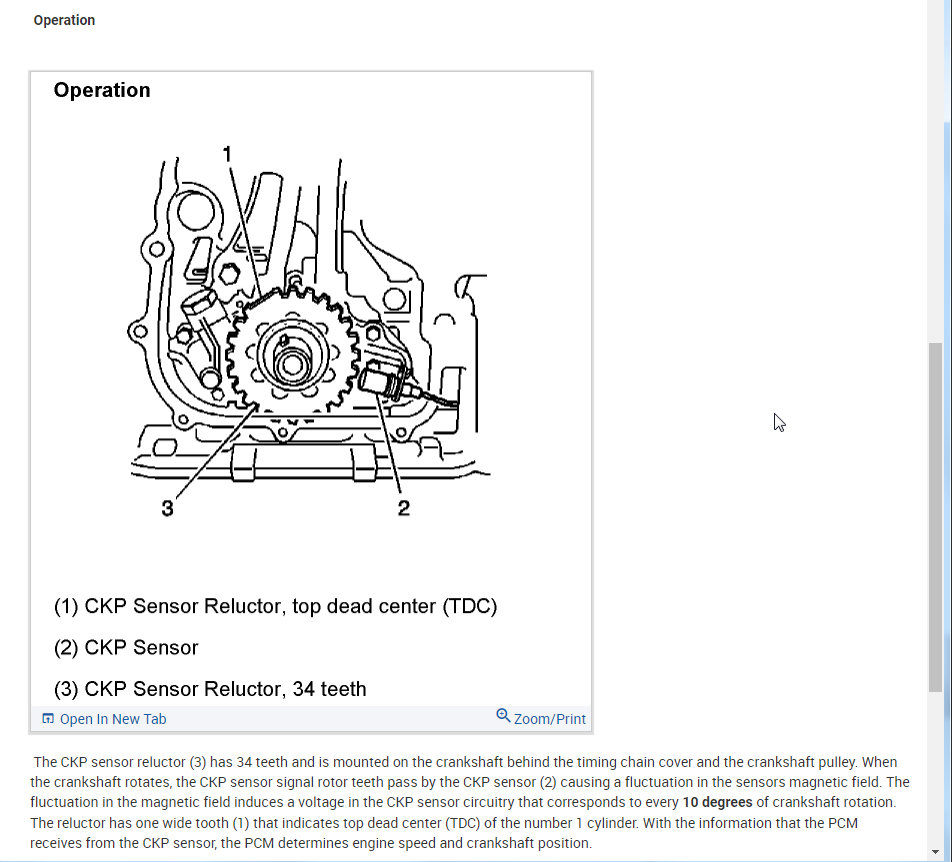

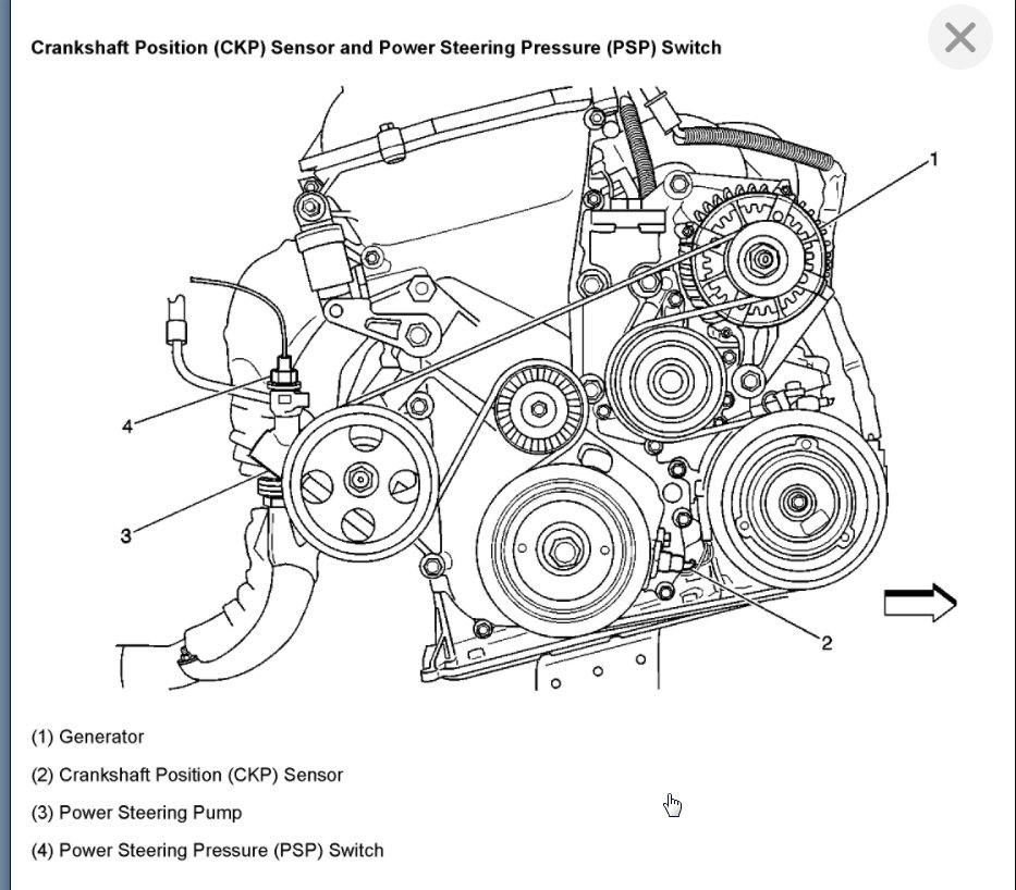

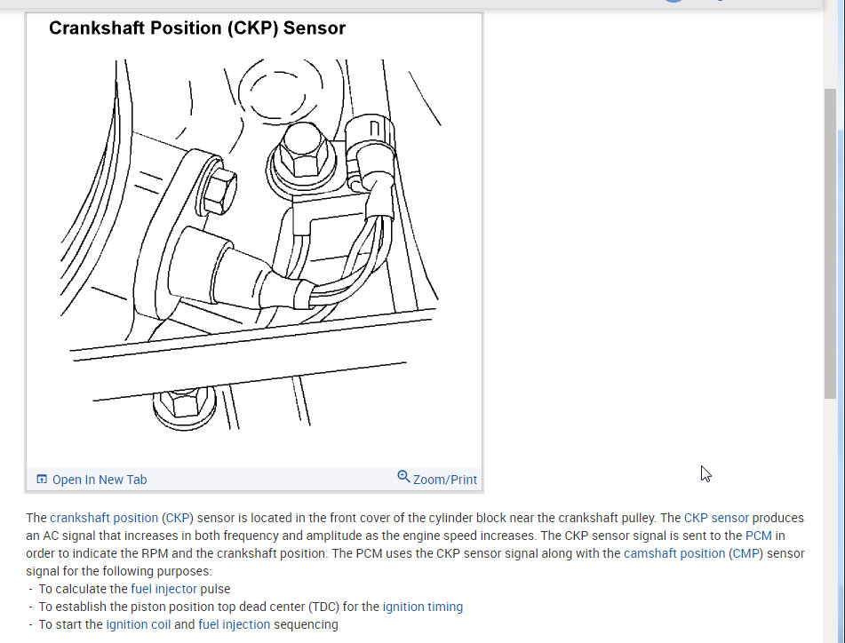

Where is the harness connector for the crankshaft position sensor?
I have removed the crankshaft position sensor, but cannot find where to disconnect it from the harness.
Sep 11, 2017 at 11:17 AM
Take a look at the attached information below. This will show the sensor and the harness that you just need to trace back about 6 inches until you find the connector where you can unhook it.
Also, here is some more information that will help for this:
Please review this and let us know what information you need. Thanks
