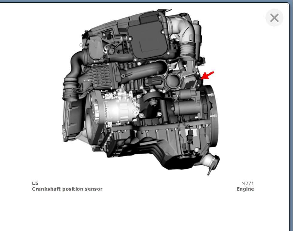

I got the code p0017 and p0138. now I try to solve the p0017 first for crankshaft position sensor but I do not know where is the sensor on my car. can you tell me please me? Thank you
Mar 7, 2017 at 8:08 PM

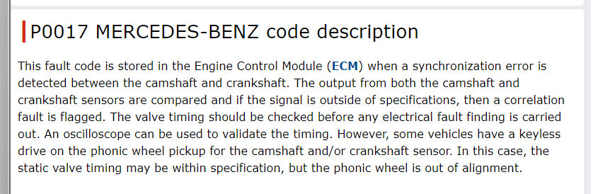

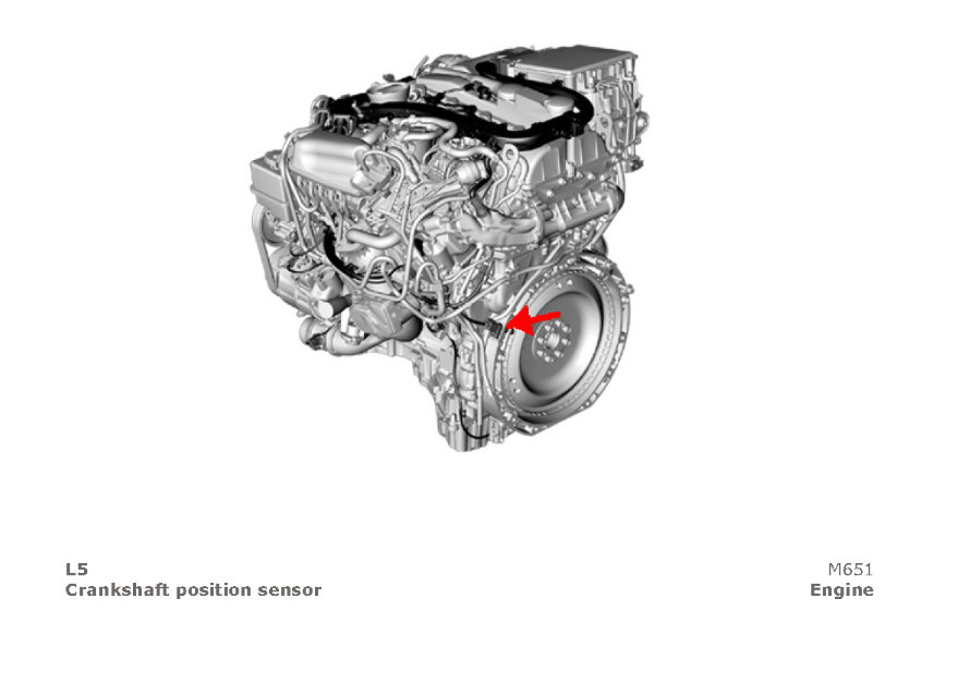

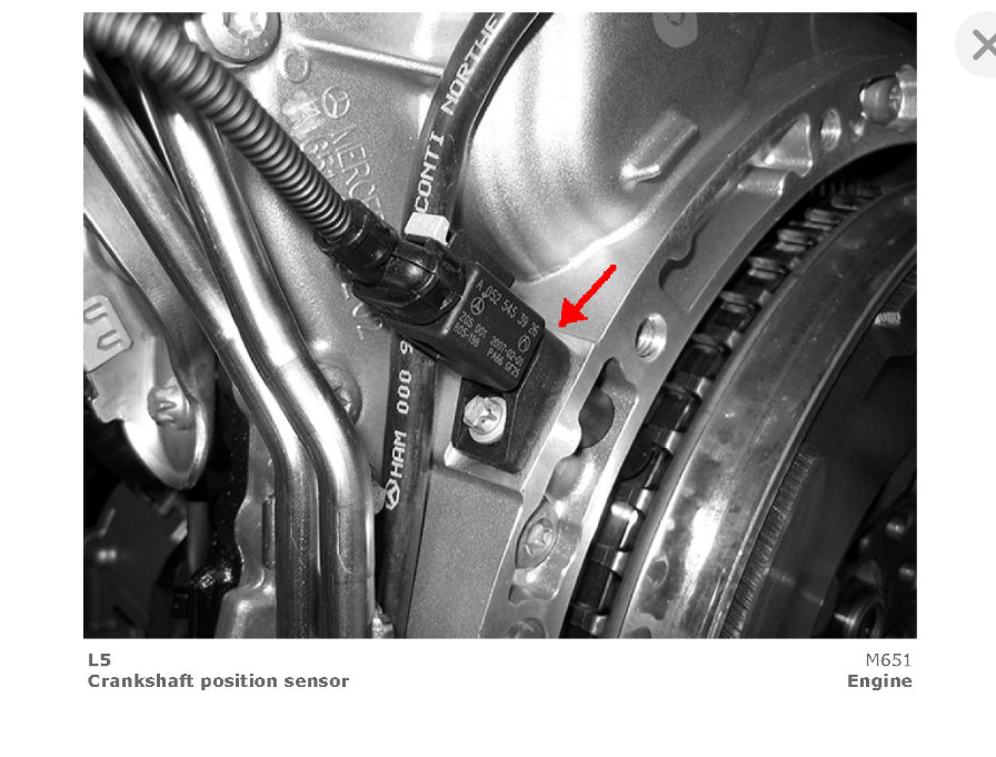

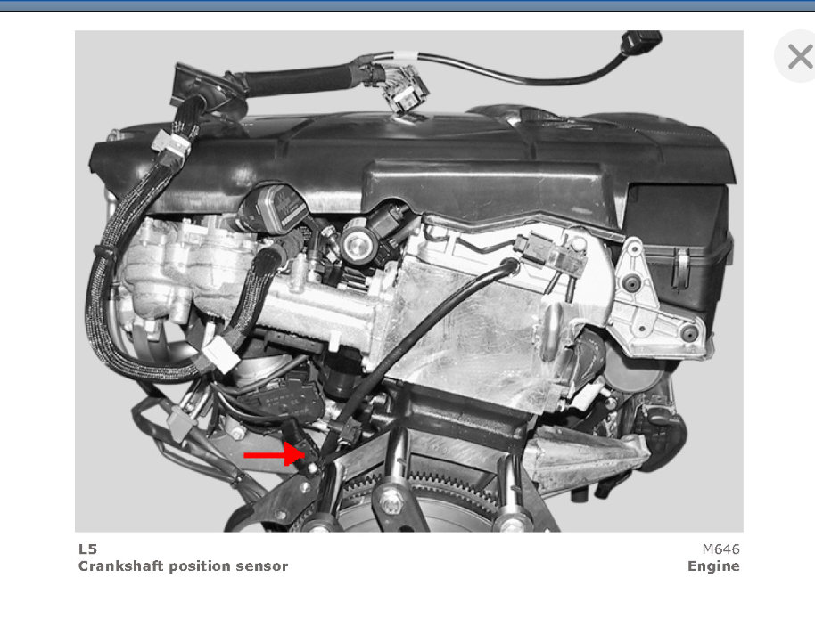

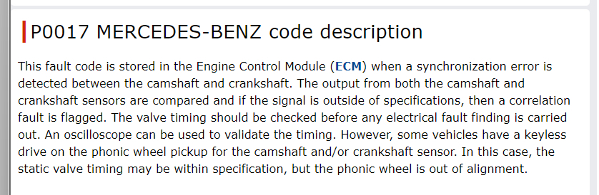

I am attaching the location below but here are a couple guides that may have some useful info in it for this issue.
I am attaching multiple different location views for this so please run through this and let me know if you have other questions.
Thanks
