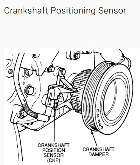

I found out that my truck listed above needs the crank shaft position sensor, and I do not know where it is or how to do it.

The crankshaft position sensor is located at the front crankshaft pulley, at about 10 O'clock.
See image below.
A good video on how to replace:
https://youtu.be/fmg62oQaK6Q?si=_RdjKykJtpek0BSN
You will need to remove the battery to make space to remove the intake air pipe.
How to remove battery:
https://www.2carpros.com/articles/how-to-replace-a-car-battery
Cheers, Boris
