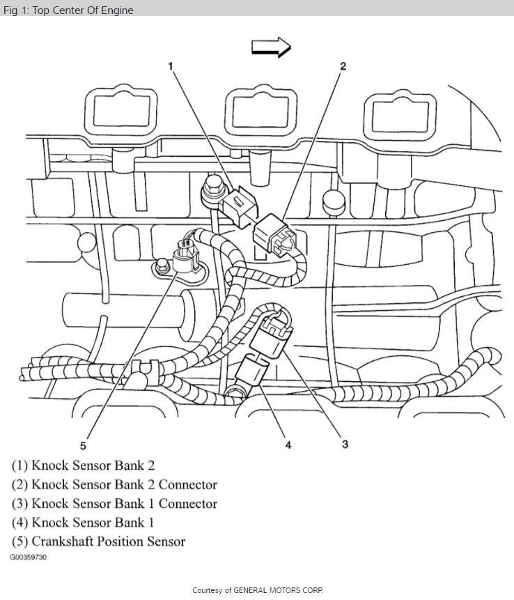

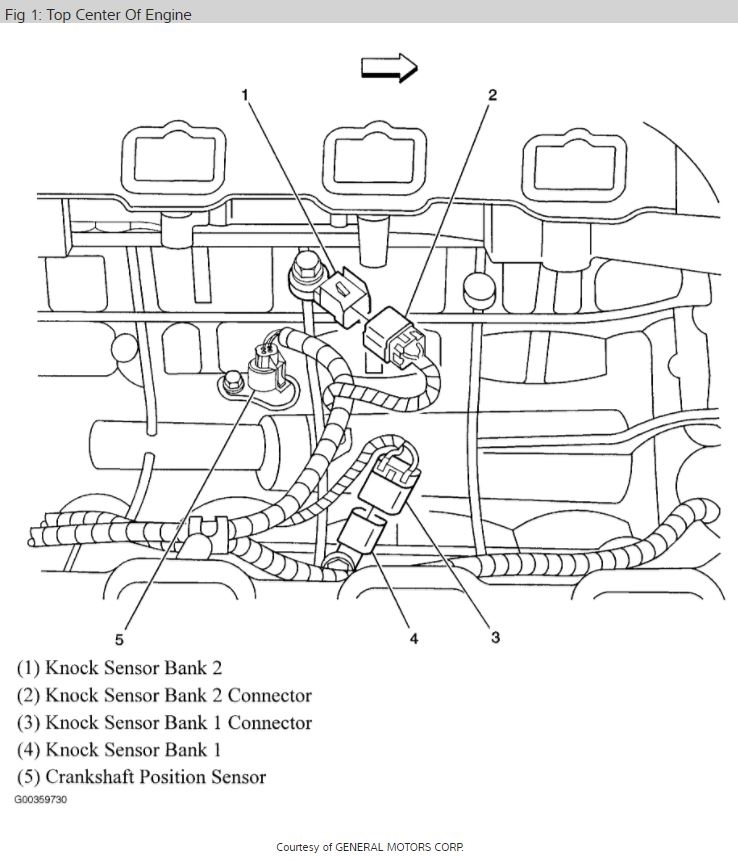

Hi, I just need to know the location of the crankshaft position sensor for the car listed above.
Apr 4, 2018 at 10:27 AM
PATENTED_REPAIR_PRO
  • 1,853 POSTS
Under the intake manifold. Check out the diagrams (Below). Please let us know if you need anything else to get the problem fixed.

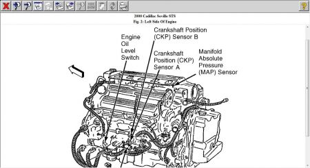

I need help with the location of the crank position sensors. I understand there are 2 on my car- 2000 Cadillac STS, an upper and a lower. Does anyone know where these two sensors are located and the degree of difficultly in replacing them?
Thanks,
Terry
Sep 7, 2020 at 11:48 AM (Merged)
  • 75,992 POSTS
Here's the location dunno how hard to get at it
https://images.2carpros.com/forum/automotive_pictures/12900_cps_33.jpg
TLSPURS
Is that the FRONT (where the radiator is) of the engine, it seems to be.
  • 75,992 POSTS
On left side of engine block near base of engine oil level indicator
