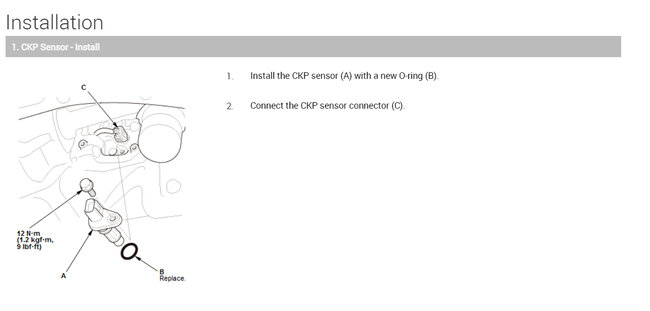

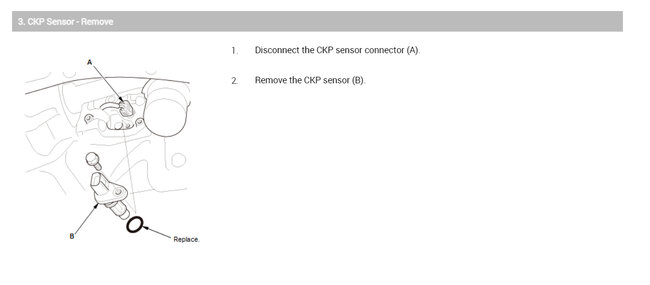

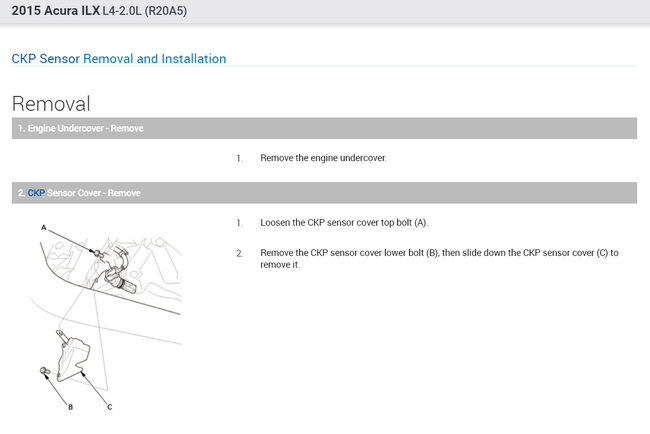

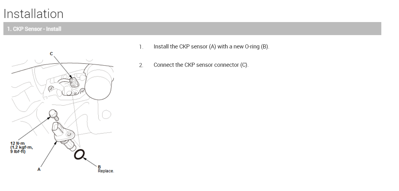

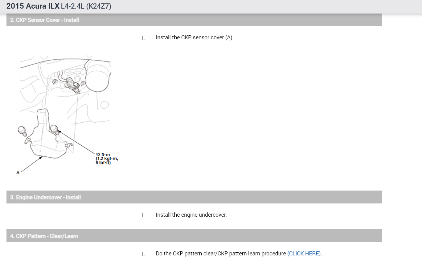

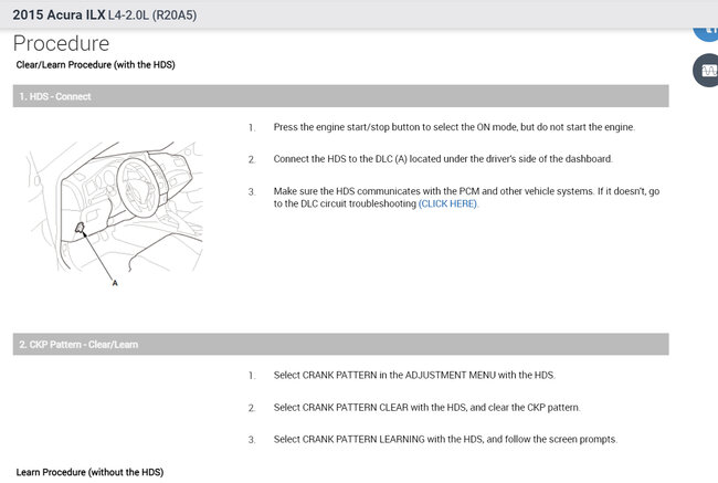

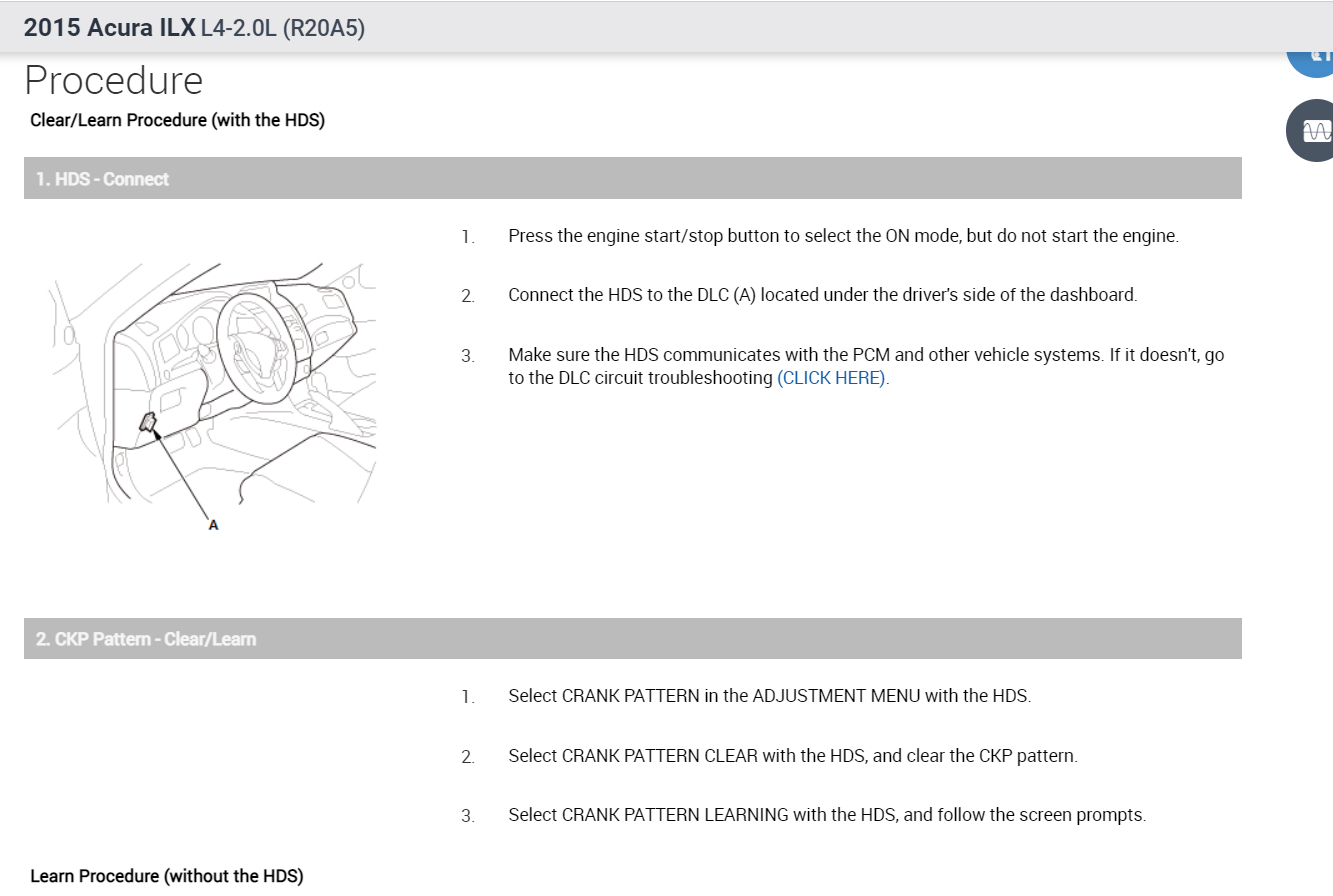

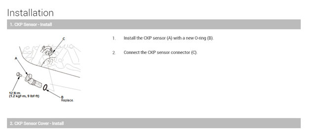

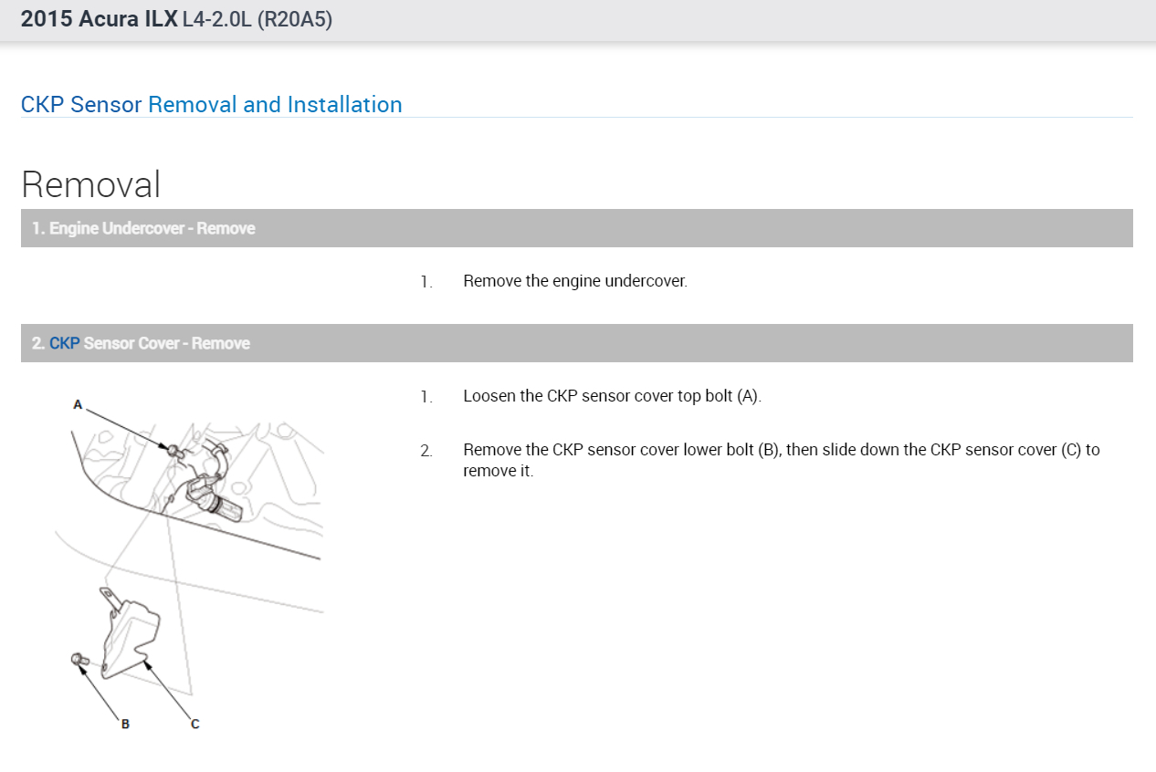

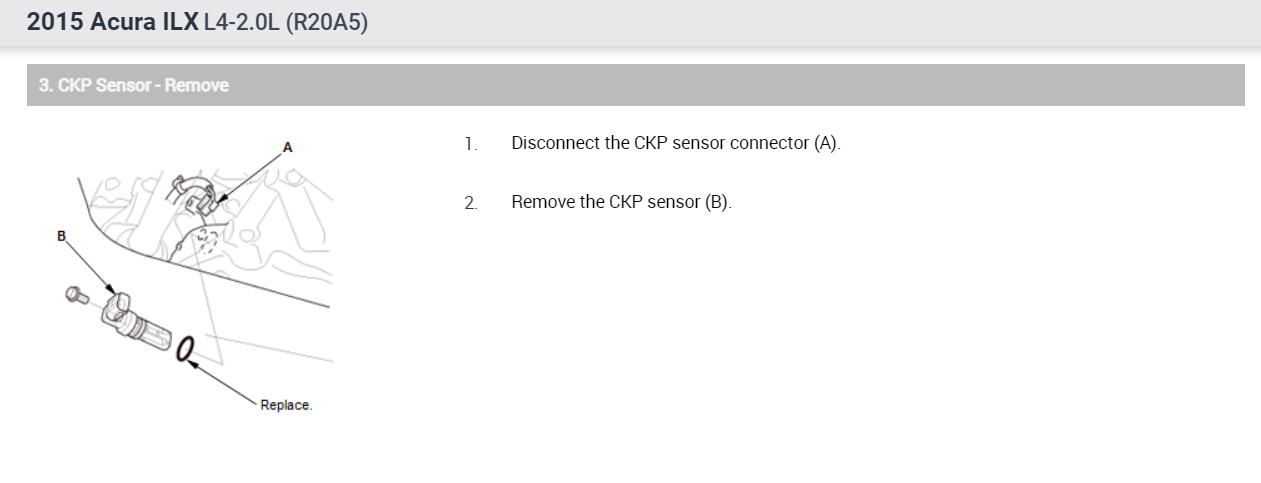

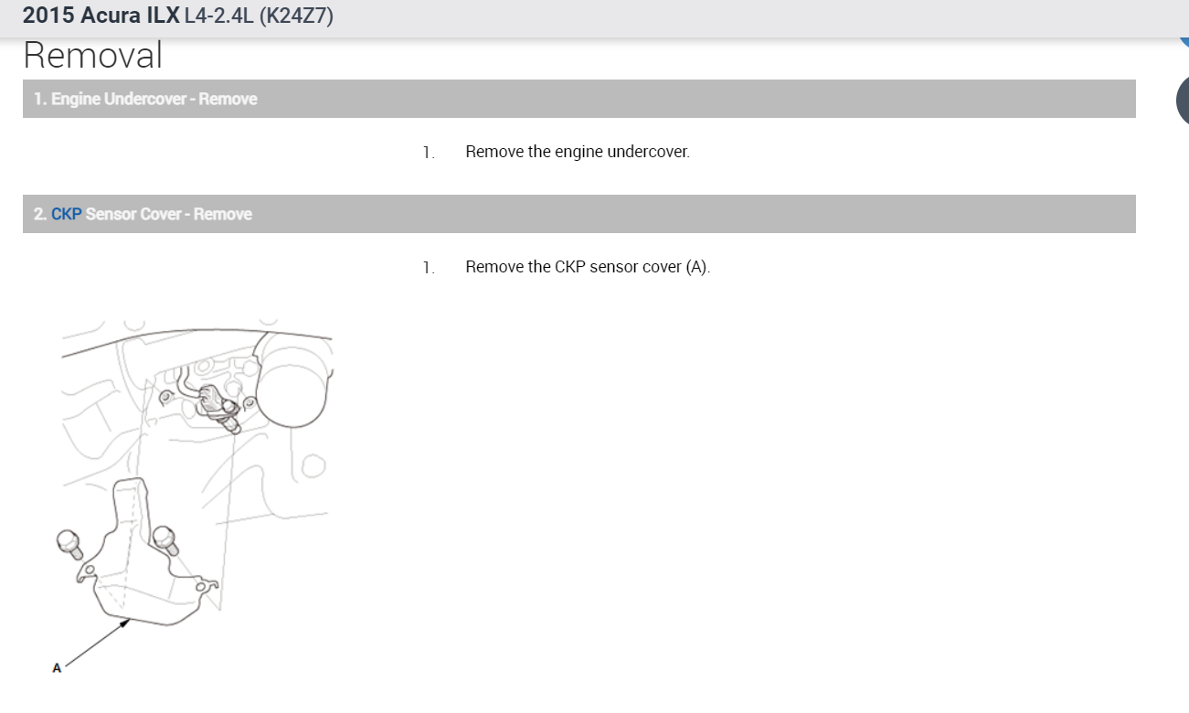

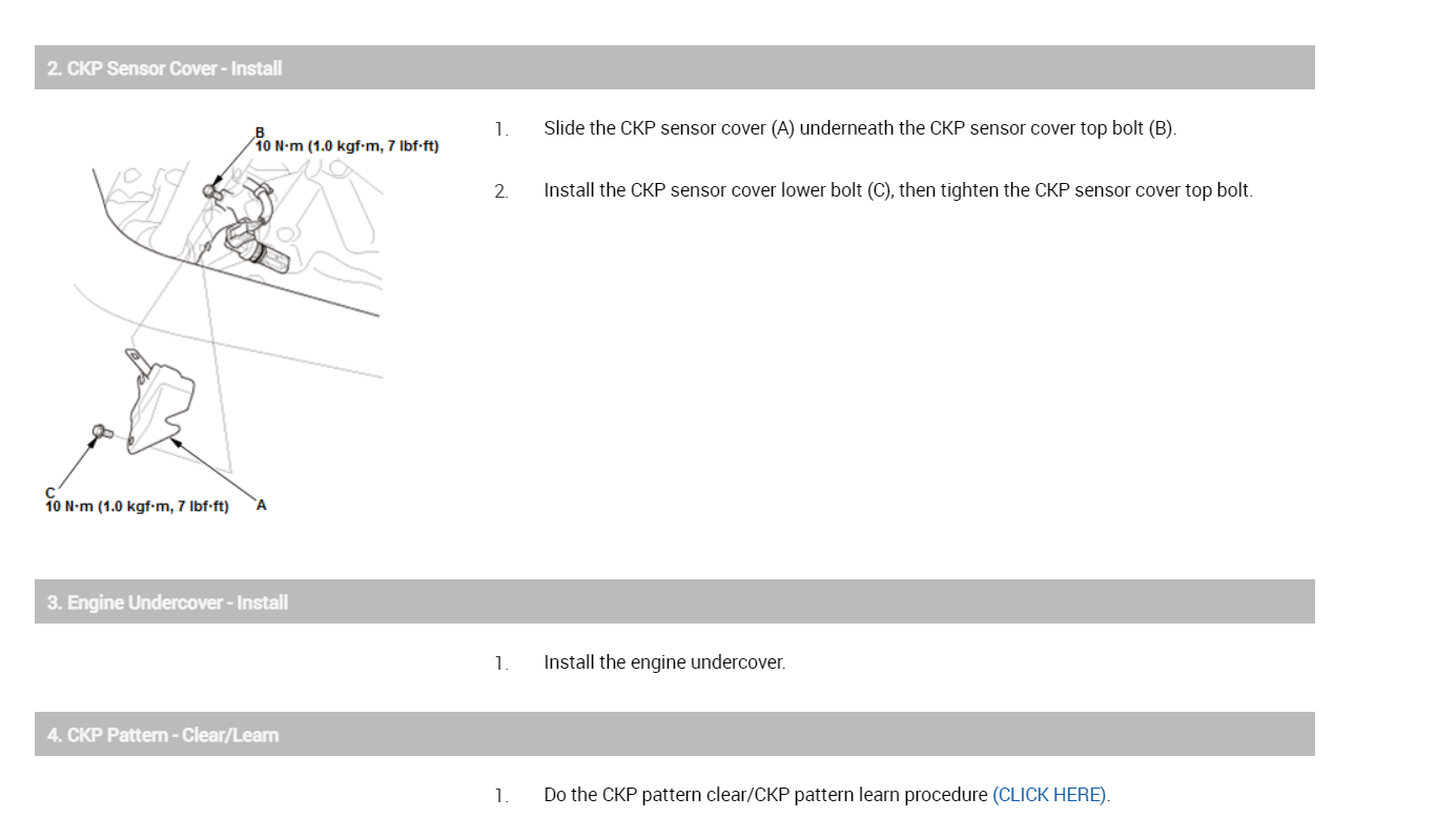

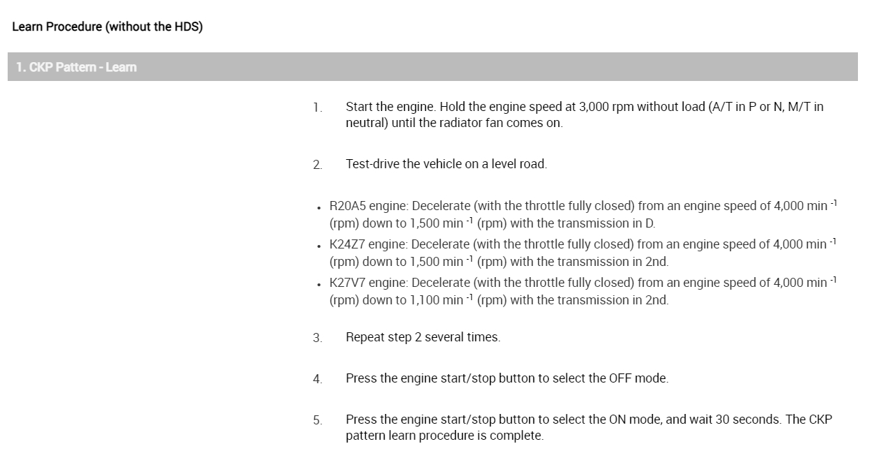

Where would my crankshaft position sensor be located? I am trying to replace it my self but I can’t find any videos on where it would be located. Please help
May 12, 2023 at 12:40 AM
  • 55,395 POSTS
It looks like the crankshaft angle sensor is near the oil filter on both the 2.0 and the 2.4-liter engine, I have also included the relearn procedure using the scan tool and without the scan tool. Check out the images (below). Please let us know if you need anything else to get the problem fixed.
