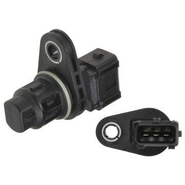

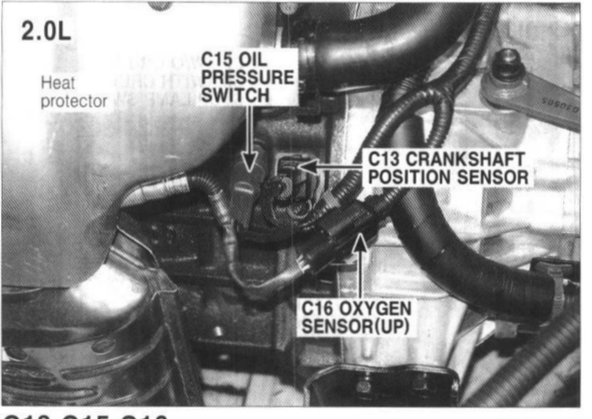

Please I cannot figure out the location of there the sensor is! Pictures would be amazing!

It is on the exhaust side of the engine toward the transaxle as shown and looks like the attached image. It unbolts and then pulls out of the block. Then clean the surface really well and slip the replacement back in and tighten the bolt down snug. Might I ask why you want to replace it?
