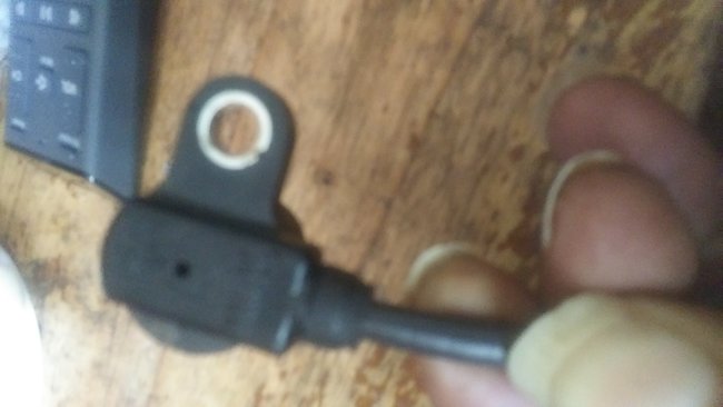

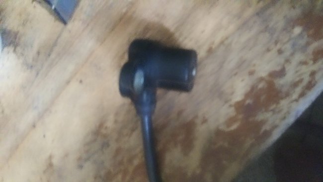

I am changing crankshaft position sensor and the old one seems to be stuck in place to the crankshaft.Do I pry it off?

Is there an air-gap?
Jul 7, 2020 at 1:50 AM
Good afternoon,
If you pry it, you will break it.
Try twisting the sensor as the o-ring is what is stuck. Once the o-ring moves, then lube the sensor with WD40 or some other lube.
Then it will come out.
As far as the air gap, it cannot come in contact with the crankshaft.
CRANKSHAFT POSITION SENSOR REPLACEMENT
1. Disconnect the negative battery cable.
2. Disconnect the crankshaft position sensor connector.
3. Remove the crankshaft position sensor.
4. Install in the reverse order of removal.
Tightening torque: 7.9 - 10.7 N.m {80 - 100 kgf.cm, 69.5 - 95.4 in.lbf}
5. Inspect the air gap.

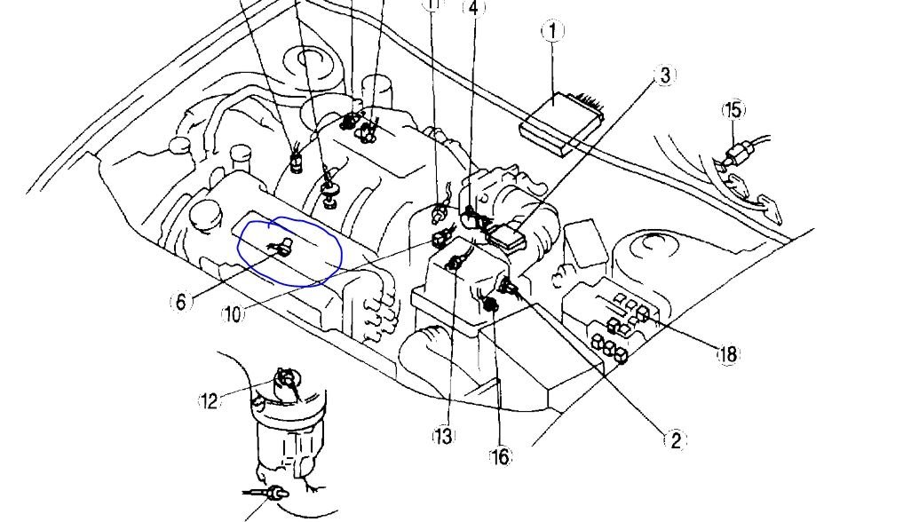

Removal & Installation (Except B2500, B3000 & B4000)
Disconnect negative battery cable. Sensor is located on front of engine, near crankshaft pulley. Remove engine undercover. Remove sensor bolts and sensor. Disconnect wiring connector. To install, replace sensor and
loosely install mounting bolts. Using a feeler gauge, adjust sensor air gap to .020 .060" (.5 1.5 mm). To complete installation, reverse removal procedure. Tighten bolts to specification. See TORQUE
SPECIFICATIONS.
