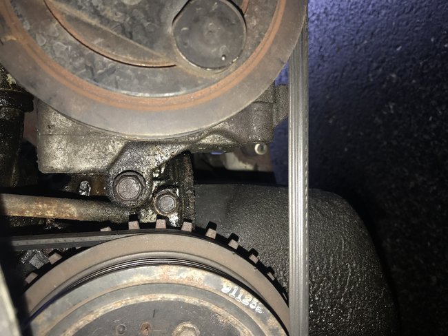

My car stopped running because of the crankshaft position sensor, upon inspection I found that the bolting part of the sensor was broken off and no longer attached to the car. The issue I’m having is I cannot located where I will be bolting the new sensor into. I’m not sure if the old bolt is still lodged into the car.

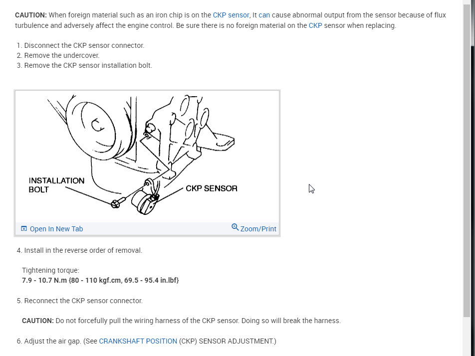

Hi Cars522,
I attached the process on how to replace it. It shows the placement for the bolt. It is just next to the crankshaft pulley.
Let me know if you have any other questions. Thanks

CARS522
The entire sensor has to be attached to the car for the car to start again correct? By entire I mean the bolting part and the plug in part. Just double checking because I attached the plug in part and the car didn’t start.
Jul 31, 2019 at 8:15 AM
Yes. You need to have it bolted in because if the air gap is too large it won’t pick up the tone wheel gaps which will cause a no start.

CARS522
Is this the correct place? Is it the smaller bolt where it should?
Jul 31, 2019 at 10:00 AM
Yes. The one on the right looking at the picture. That looks correct. I would pull this out and make sure it has the ear of the old crank sensor that should still be there. That will confirm it. It looks like it is there so it appears correct.
