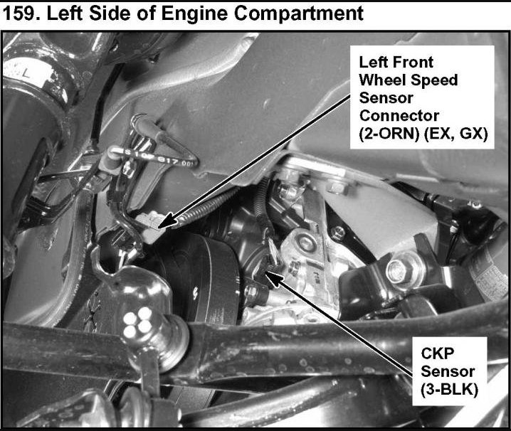

Where is the Crankshaft Position Sensor located?
2015 HONDA ODYSSEY
80,000 MILES • 2.5L • 6 CYL • 2WD • AUTOMATIC
LARISSA K IVY
Is it hard to get to?
Jun 12, 2022 at 9:01 AM
SQM
  • 6,383 POSTS
The crankshaft position sensor is located on the lower left side of the engine compartment.

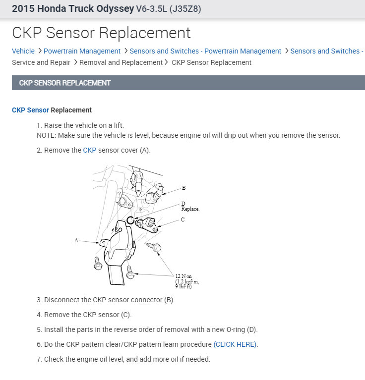

You will have to raise the vehicle to access it (see diagram below).
Keep in mind that the vehicle has to be leveled before taking out the sensor, otherwise oil will drip out of the sensor hole.

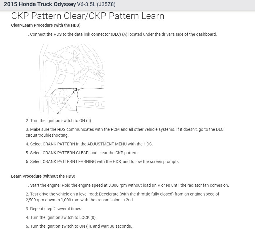

Also, the new sensor will have to be programmed to the vehicle using an appropriate scan tool.
I have attached disarms including the relearning process below for your reference.
