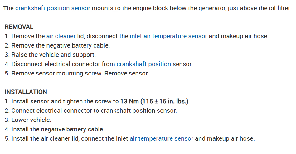

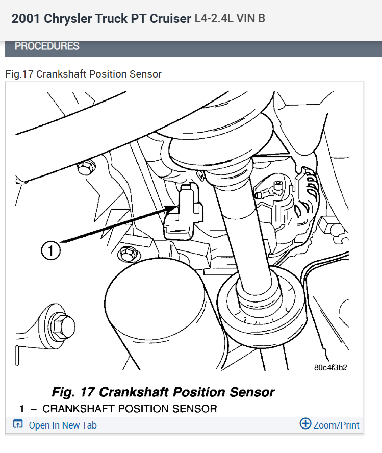

O man, sorry about that, my bad. Please give me the code to see what is going on, in the meantime here are the instructions of the job being done so we can be on the same page.

I changed the crankshaft position sensor already. At first it made no difference so we disconnected the battery and it was good for a day then back to bad and throwing code for crankshaft position sensor again

The code for my 2001 PT cruiser is P1391. Changed crankshaft position sensor-not fixed. Cleared coats using OBD scanner. Ran good for about a half day then back to bed and check engine light coming on again
Aug 25, 2026 at 4:44 AM
  • 55,721 POSTS
The P1391 code does not specifically mean the new crankshaft position sensor is bad. On this Chrysler system, P1391 means the PCM is intermittently losing either the crankshaft position (CKP) signal or camshaft position (CMP) signal. I would replace the sensor pigtail and then clear the codes. Here is the part for $15
