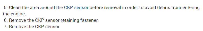

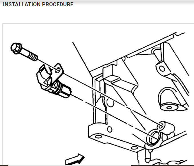

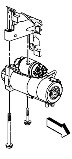

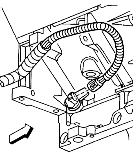

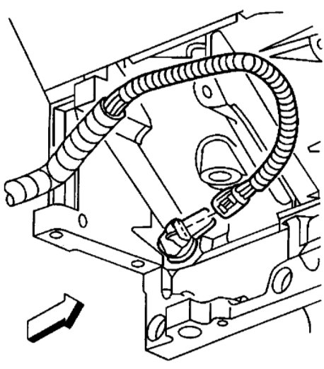

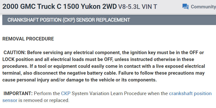

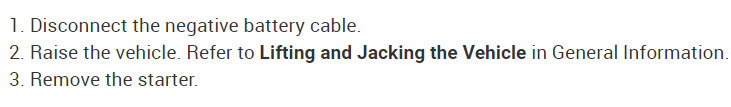

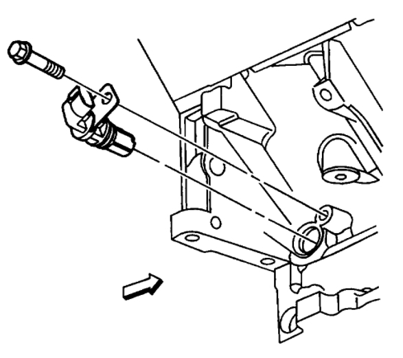

My crankshaft position sensor is smaller in diameter than the design one. I was told that the brass cup inside needs to come out. Need instructions on how to do it.
Oct 9, 2019 at 9:47 AM
DANNY L
  • 5,648 POSTS
Hello, I'm Danny.

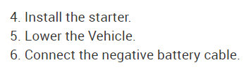

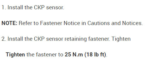

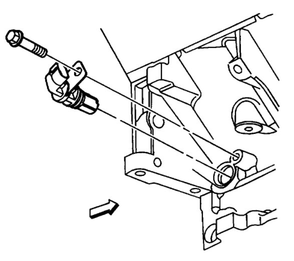

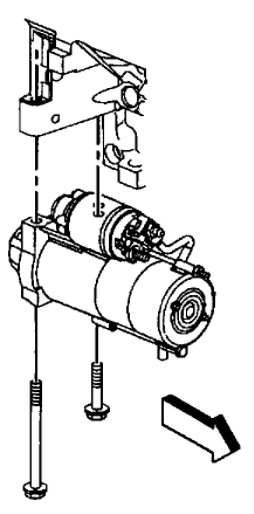

Here are the instructions you've requested on removing and replacing the crankshaft position sensor. Here is a tutorial to view for replacement:

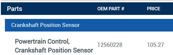

I've attached picture steps below for your crankshaft position sensor replacement on your vehicle. I've also attached a picture below of the correct GM part number for your sensor. Hope this helps and thanks for using 2CarPros.
