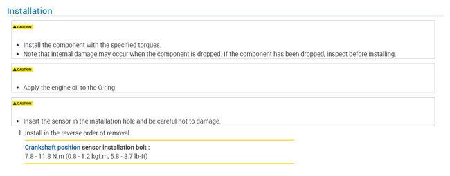

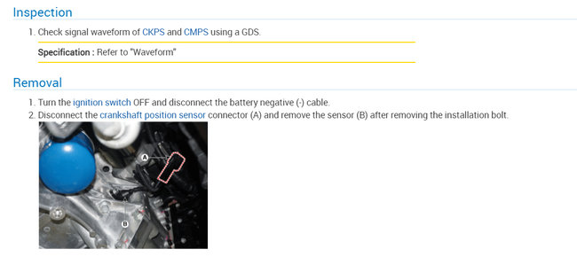

I have looked everywhere online, and I cannot find where the crankshaft position sensor is on my car.
I do not like taking it to shops, they charge so much.
Can you please help me??
I have the part, but there are no manuals for my car.
Mar 24, 2022 at 6:30 AM
  • 55,562 POSTS
It looks like the crankshaft angle sensor is near the oil filter. Here is the exact location in the diagrams below. Check out the diagrams (below). Let us know what happens and please upload pictures or videos of the problem.

I cannot express how much you helped me. I got the sensor out and let the engine reset the sensor.
No light on dash, no hesitation, drives awesome again. Thank you so much!!
Now I am going to treat myself to an oil change. Have a great day!!!
