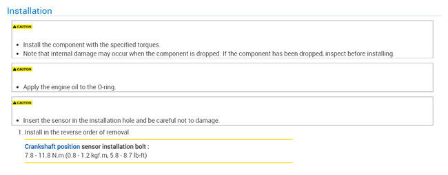

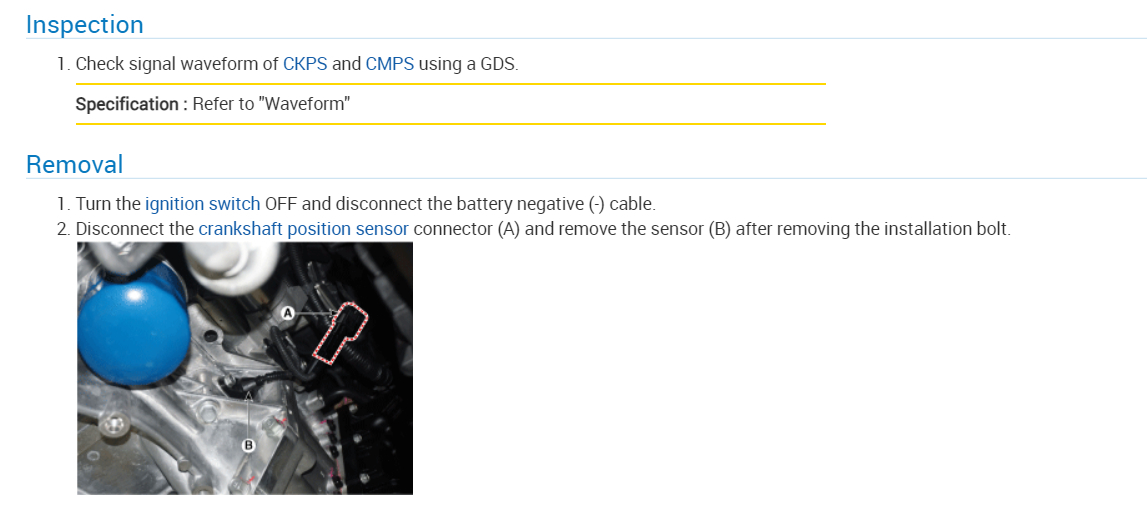

It looks like the crankshaft angle sensor is near the oil filter. Here is the exact location in the diagrams below. Check out the diagrams (below). Let us know what happens and please upload pictures or videos of the problem.

I cannot express how much you helped me. I got the sensor out and let the engine reset the sensor.
No light on dash, no hesitation, drives awesome again. Thank you so much!!
Now I am going to treat myself to an oil change. Have a great day!!!
