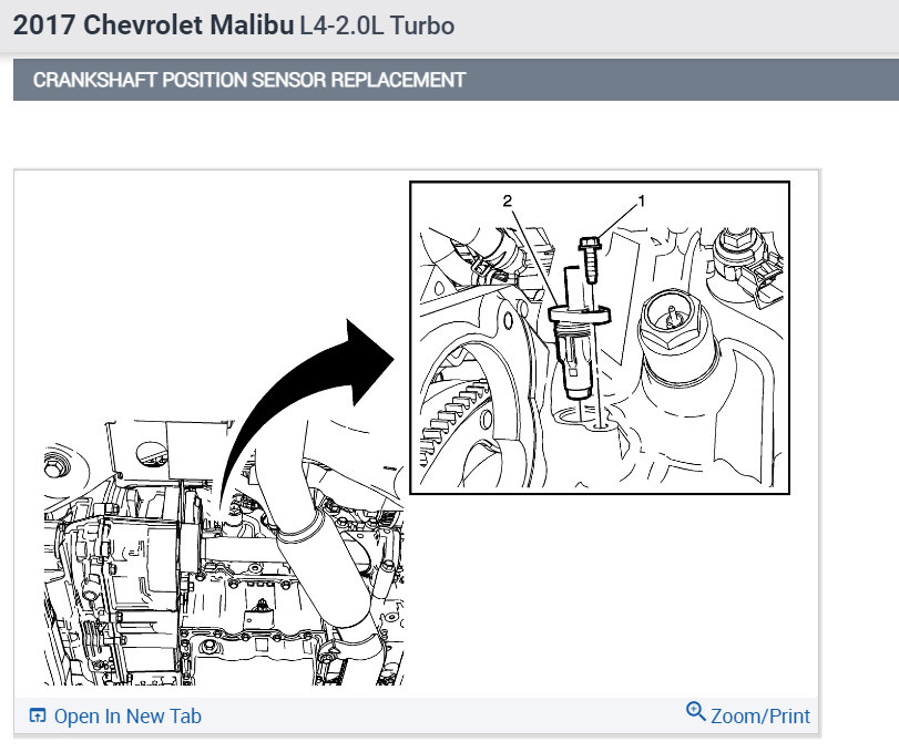

Where is the Crankshaft position sensor located?
88,577 MILES • 2.0L • 4 CYL • 2WD • AUTOMATIC
K THOMAS
  • 17 POSTS
Trying to find the location of the crankshaft position sensor on my car listed above premier 2.0L turbo.
Aug 14, 2023 at 12:20 PM
  • 55,721 POSTS

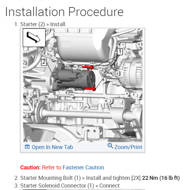

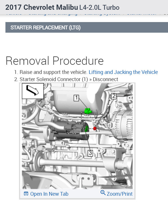

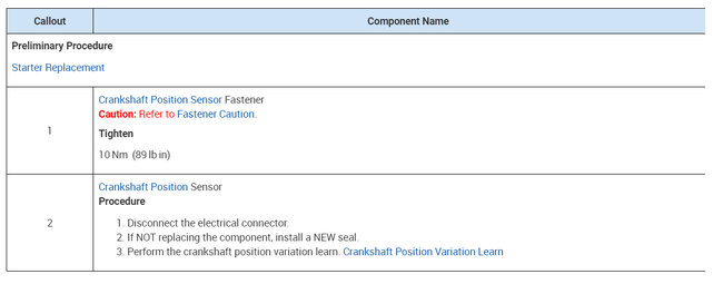

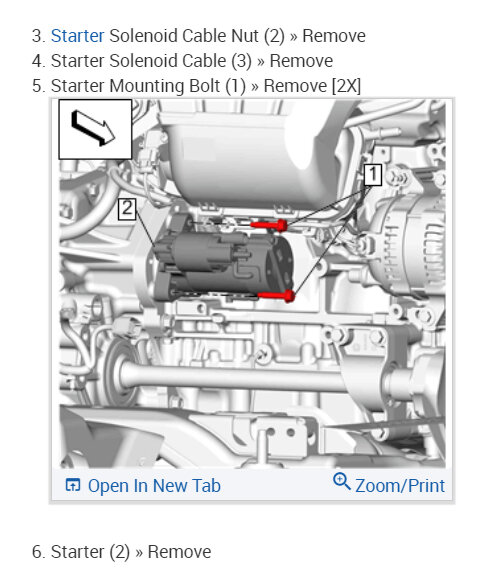

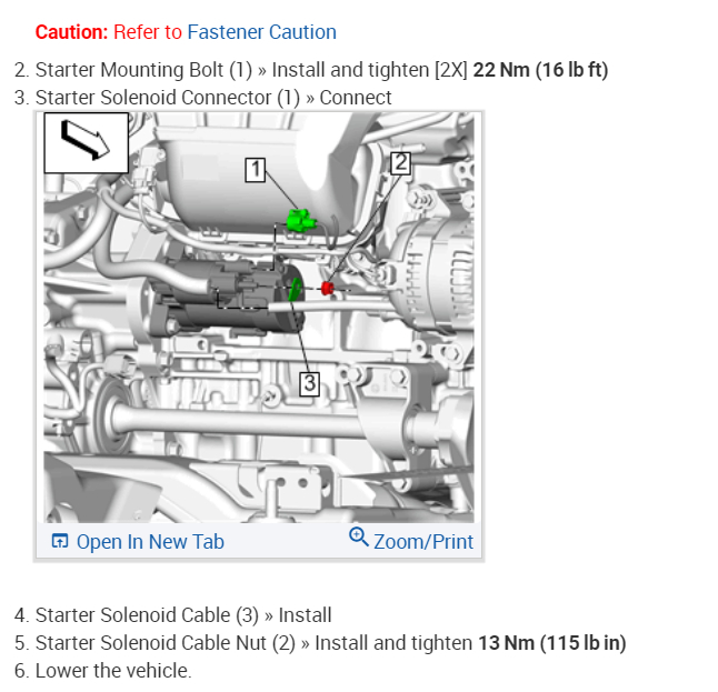

Here is the location of the crankshaft position sensor which is on the right side of the engine behind the starter motor. To begin, disconnect the negative battery cable to power down the system. Check out the images (below). Please let us know if you need anything else to get the problem fixed.
Aug 15, 2023 at 3:42 AM
