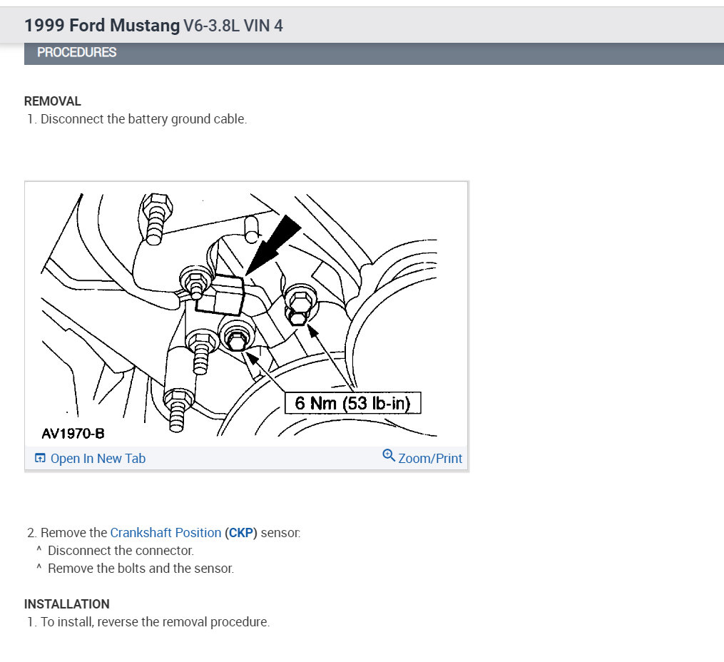

crankshaft position sensor where is it and how do I replace it?
1999 FORD MUSTANG
200,000 MILES • 3.8L • V6 • 2WD • MANUAL
CHRISTIANMAN06
  • 6 POSTS
crankshaft position sensor location and replacement instructions needed.
Aug 13, 2022 at 4:14 AM
  • 55,423 POSTS
It looks like it is down by the front main pulley. Here is a guide below to show where it is and how to replace it. Check out the diagrams (below). Please let us know what happens.
