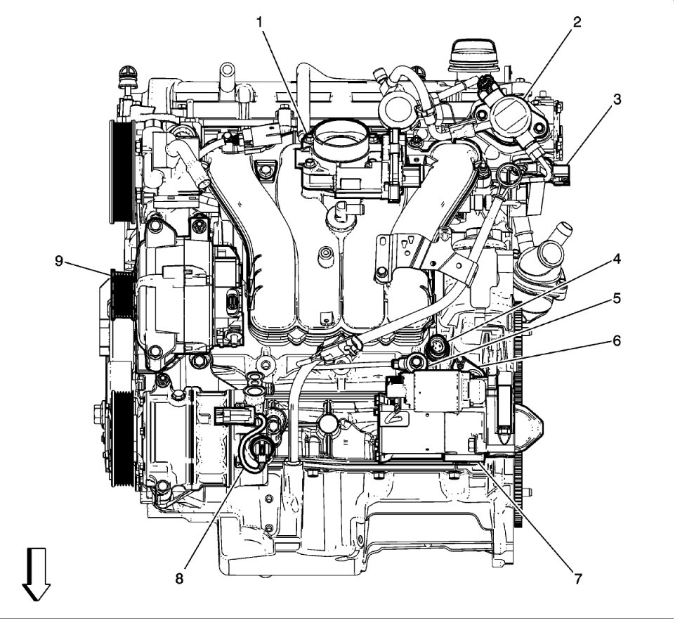

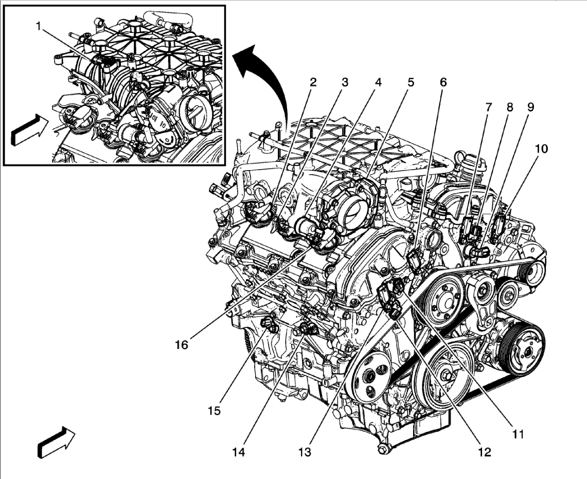

Where is the sensor for this ,is it hidden out of view. Having trouble finding it.If you had a picture that would be nice. Thanks Ole
Dec 24, 2015 at 6:30 AM
HMAC300
  • 48,601 POSTS
Here is a guide and diagrams below for both engine that fit in that car. You will need to do a relearn on the sensor for the engine to run. Here is a guide and instructions on how to do the job.
