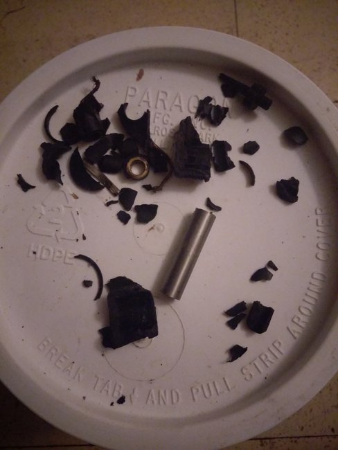

Thanks! I finally got it out however when it came loose the plastic casing exploded and left remnants behind in the cylinder which I have removed most of. I pulled out just the metal cylinder of the CPS and have tried removing most of the casing however there is still some left with a metal circle in the middle. Is this part the end CPS and can I still drill and pull or is this the crankshaft? Removing the rest of the casing is extremely difficult with limited space and only using a small mirror let alone make shifting a tool that can pry up the secured casing. Any suggestions? Thanks

Here is a picture of what I have removed.
Wednesday, March 27th, 2019 AT 5:31 PM

I'm wondering if what's left in there is the cone piece after the metal cylinder? Thanks

Got it.
It looks like there is more of the sensor in the hole. You need to see if the remaining plastic is still in the hole.
Does the new one fit in the hole?
Thursday, March 28th, 2019 AT 5:27 AM
IAN HOHMANN
  • 6 POSTS
There is still remaining plastic in the hole and I assume the end of the CPS that didn't come out. Which would be the best way to remove? I'm thinking to lightly tap with screw then pull? I haven't tried putting the new one in because of the remaining remnants and I don't want to push in further where I cannot remove.
Thursday, March 28th, 2019 AT 6:11 AM
  • 52,797 POSTS
At this point, I doubt it will come out with a screw. There is too much missing.
You can try but I bet you will need to drop the oil pan and push it up and out of the block.
