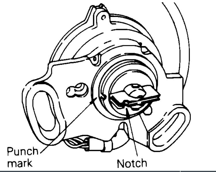

The crank and cam sensor are one unit on the back of the head.
I attached a picture for you to view and removal instructions.
NOTE: The crankshaft position and camshaft sensor are replaced as a complete unit.
REMOVAL:
1. Disconnect battery ground cable.
2. Place an alignment mark on sensor body and engine block, indicating position of sensor body in block or cylinder head. Place No. 1 cylinder to TDC of compression stroke.
3. Disconnect wiring harness from sensor.
4. Remove sensor mounting nut, then the sensor assembly from engine.
Image (Click to make bigger)
