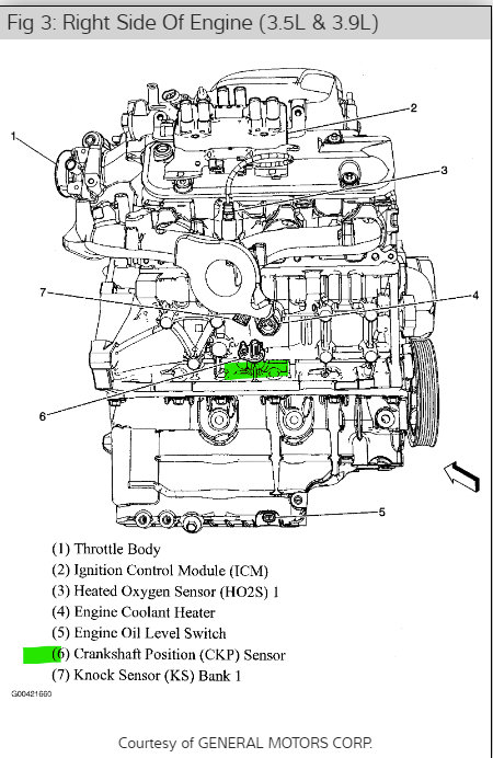

Need location of crankshaft position sensor.

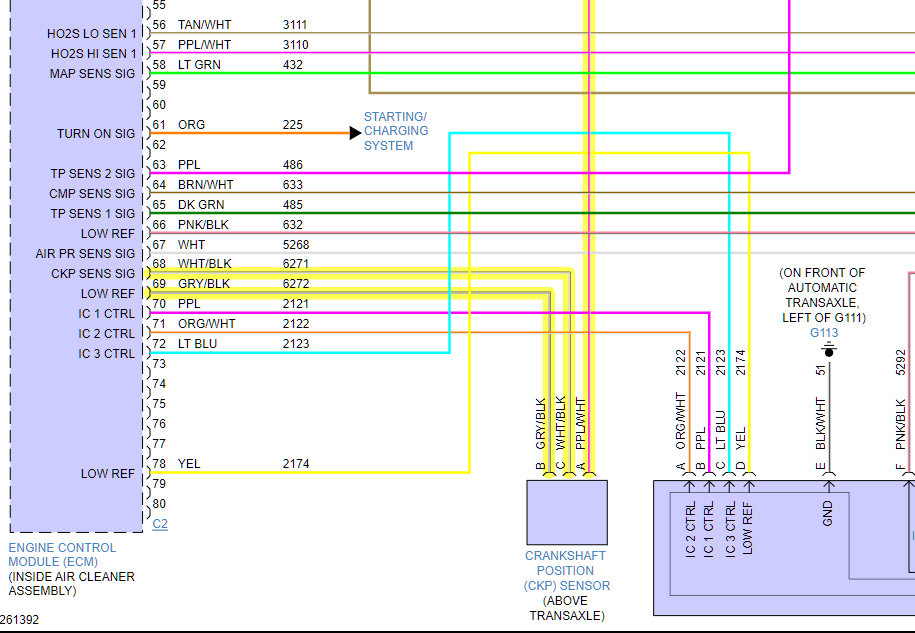

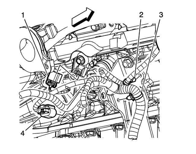

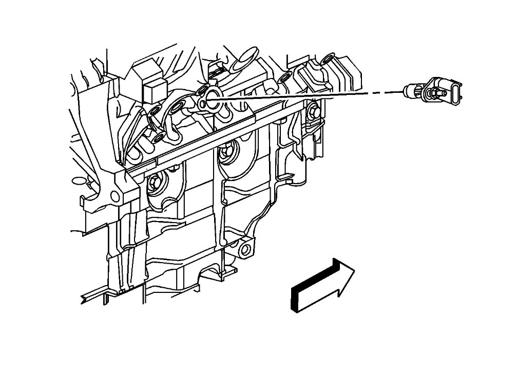

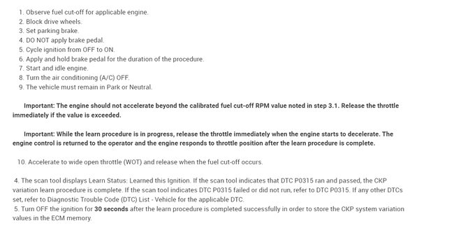

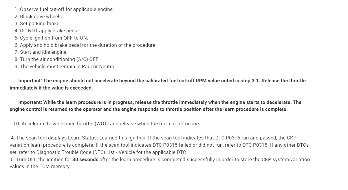

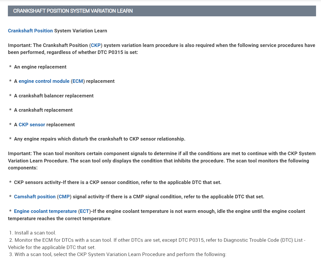

Hello, technically it's on the side of the engine, but when facing the car, it's on the back under the exhaust manifold in the side of the engine block. You must do a crank relearn procedure as well after replacing the sensor. Or the vehicle will not run right.
