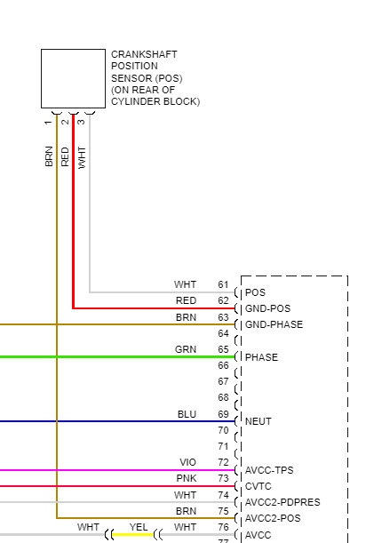

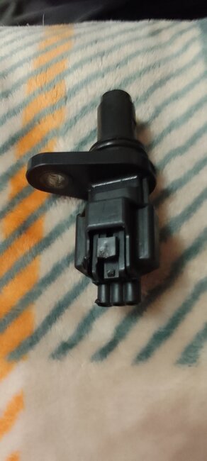

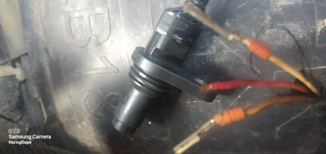

Hello, I need CPS main wire harness color code that goes into the plug. Pictures below. Thank you
Mar 14, 2024 at 11:27 AM
BORIS K
  • 836 POSTS
Please see attached diagram for crankshaft position sensor wiring.
Pin 1, brown wire
Pin 2, red wire
Pin 3, white wire
Cheers, Boris
Mar 15, 2024 at 12:34 AM
Suggested Repair
Identify the crankshaft position sensor harness by the wiring diagram: pin 1 brown, pin 2 red, and pin 3 white.
