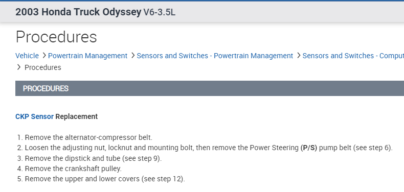

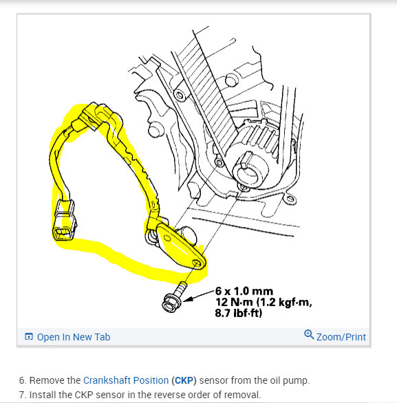

The crankshaft position sensor is located behind the timing belt cover at the bottom crankshaft pulley. It will require the removal of the crankshaft pulley and both the upper and lower timing belt cover.
If you look at the pics below, they provide the directions specific to your vehicle for replacing the sensor.
Take a look through them and let me know if you have any questions or if I can help in any way.
Take care and let me know if this helps.
