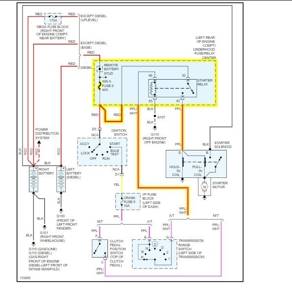

I attached a wiring diagram for the starting circuit. Can you do some testing with me for the system to find the fault?

Okay, but none of that has to do with the starting.
Can you test for power to the relay so we can find the reason it is not starting?

Relays and fuses are all good. I checked where is a multi tester to make sure they would just opening and closing that they were actually good. Seems like my ignition timing is off. I don't know how it would have happened. plus it backfired while trying to crank it a couple times yesterday like it is advanced too much.
Nov 14, 2019 at 1:18 AM
What were the powers to the relay? I need to know that voltage. We need to start somewhere and that is where we start.
