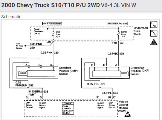

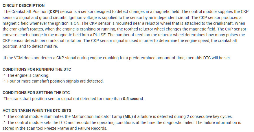

Changed crankshaft position sensor and three way wire connector since the wires were bare and gave a p0336 and now vehicle wont start it cranks i could smell gas but there is no spark. Which pin on the three way connector should have power when the key is in the on position? Also now i have no power to any fuses in the under hood fuse relay box.

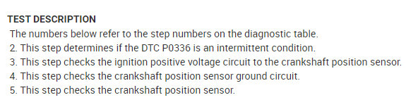

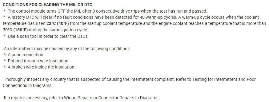

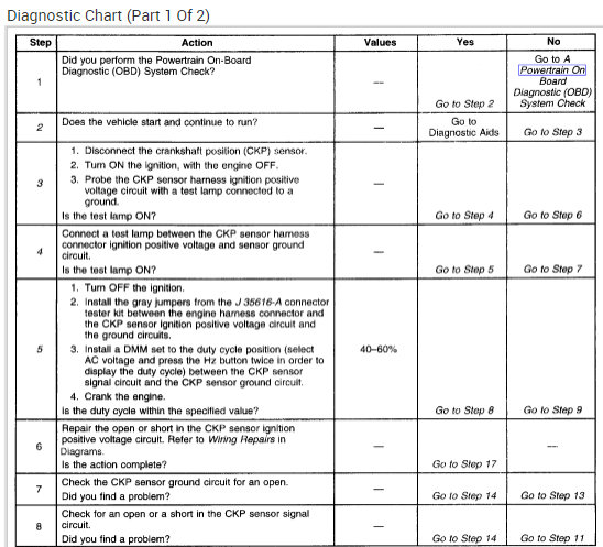

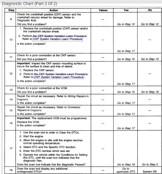

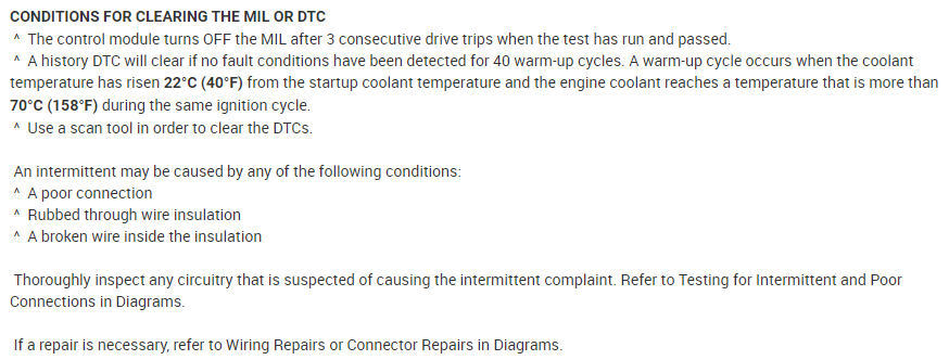

I've attached picture diagnostic steps below for code p0336 on your truck. Let us know what you find and keep us updated. Hope this helps and thanks for using 2CarPros.

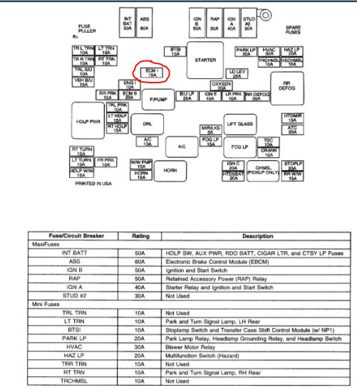

i had a and c pin wires mixed up when i started vehicle, is it possible i fried the crank sensor having the wires hooked to the wrong pins? Thanks, Joseph

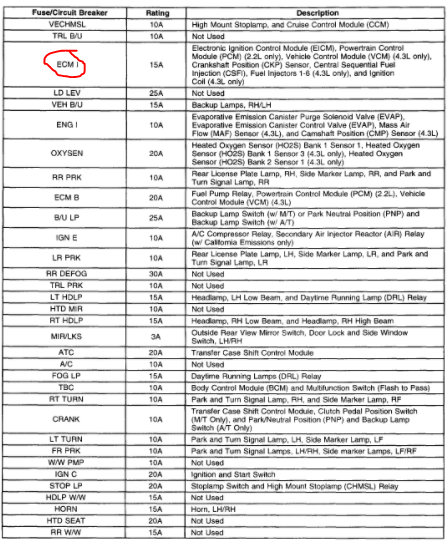

Yes, it's always possible to ruin an electrical component when the wires are hooked up incorrect. First thing to do is check the fuse. Here is a tutorial on how to test and change fuses:
I've attached a picture below showing the location of the crankshaft position sensor and circled in red. It is located in the under hood fuse box on your truck. Hope this helps and thanks again for using 2CarPros.
