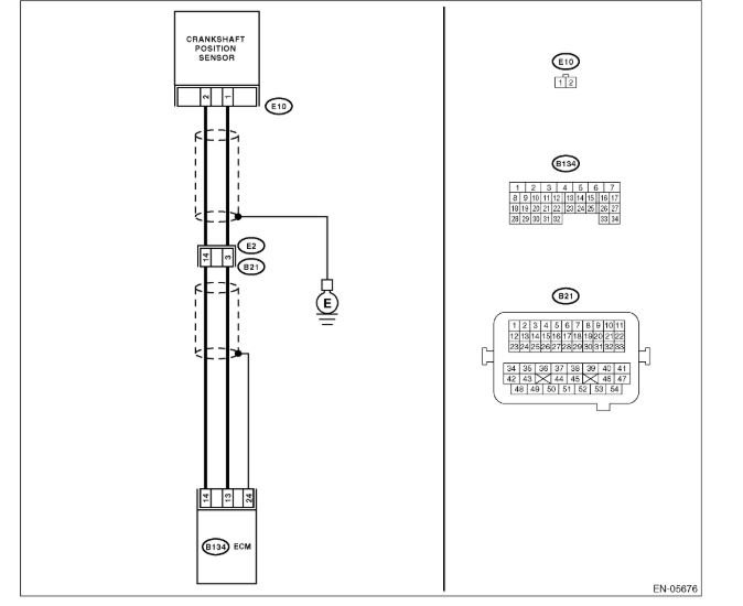

Okay, I have the vehicle listed above diesel. I'm having difficulty in finding the crankshaft position sensor. got an error code PO336 car cut out and wont restart. need help ASAP as I depend on this car for work. also it's a boxer engine.

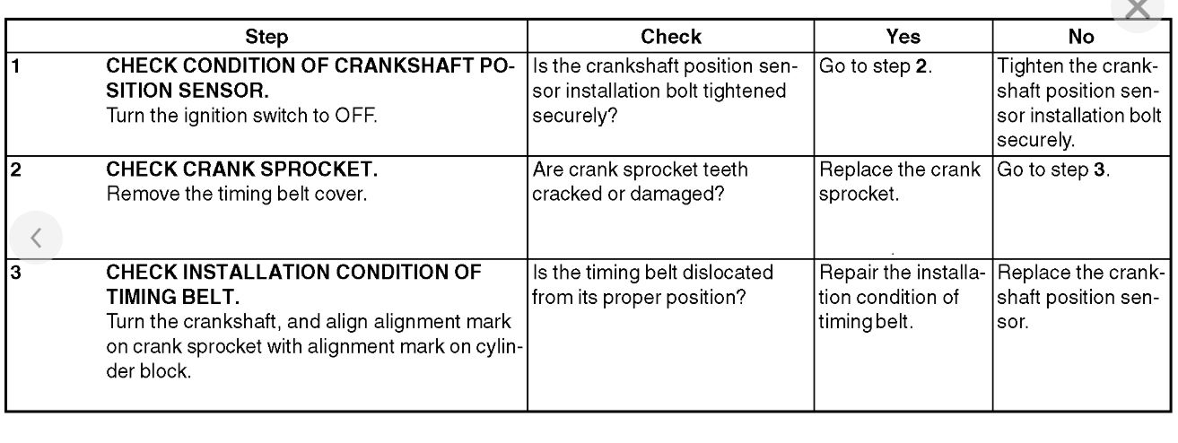

This code is for the crank sensor but the checks need to be done to verify proper voltages are being sent and received from the sensor. I attached a flow chart and a picture of the sensor for you.
DTC P0336 CRANKSHAFT POSITION SENSOR "A" CIRCUIT RANGE/PERFORMANCE
DTC DETECTING CONDITION:
- Detected when two consecutive driving cycles with fault occur.
- GENERAL DESCRIPTION See: A L L Diagnostic Trouble Codes ( DTC ) > Diagnostic Trouble Code Descriptions > P0336
TROUBLE SYMPTOM:
- Engine stalls.
- Failure of engine to start
CAUTION: After repair or replacement of faulty parts, perform Clear Memory Mode. See: Computers and Control Systems > Reading and Clearing Diagnostic Trouble Codes > Clear Memory Mode and Inspection Mode. See: Computers and Control Systems > Scan Tool Testing and Procedures > Preparation For the Inspection Mode
WIRING DIAGRAM:

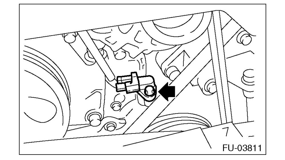

PHILL C
Just took the alternator and the A/C pump off and there is no sign of the sensor. I have checked the complete front of the engine using a camera and still no sign of the sensor. could it be located anywhere else? don't know if this helps but the engine code is EE20.

As I stated, it is under the front cover of the engine as in the picture. the front cover for the timing belt has to be removed to access the sensor.
