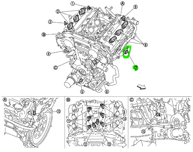

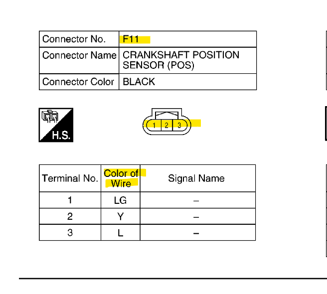

Can someone please tell me where the crankshaft position sensor on the vehicle listed above Platinum model is located? There are no videos to show the location of this year and make. Thank you
Jan 28, 2023 at 2:14 AM
AL514
  • 5,654 POSTS

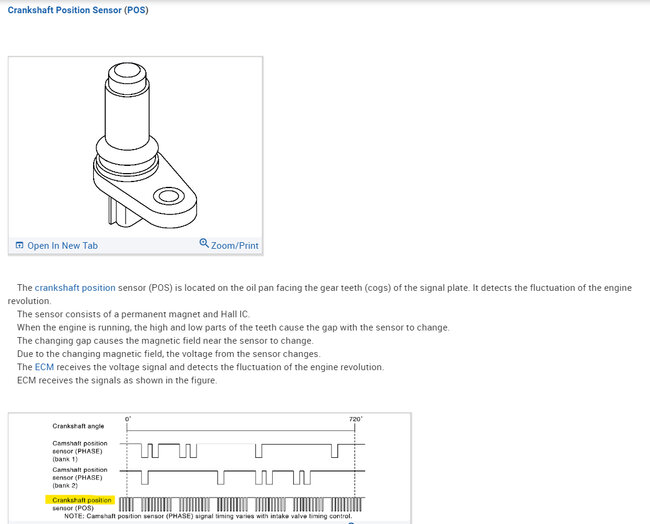

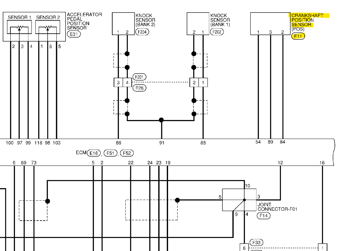

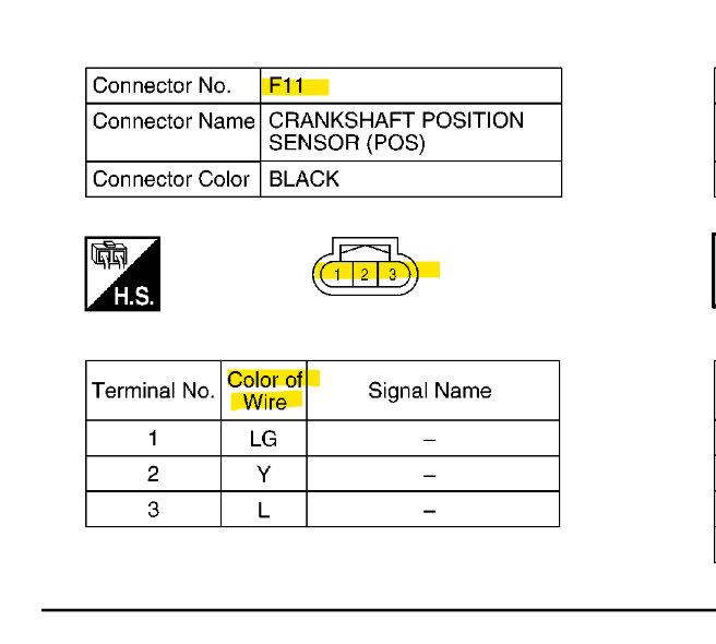

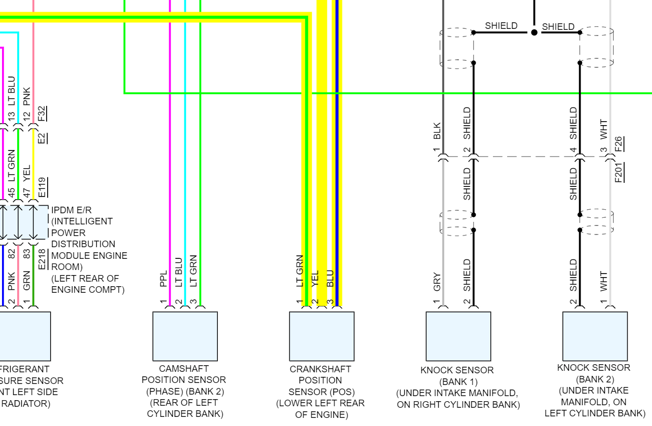

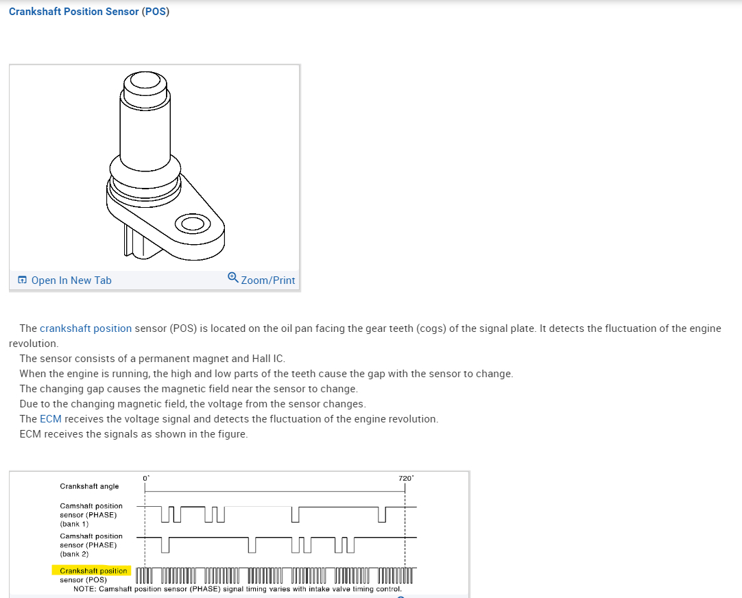

Hello, the crankshaft position sensor is located on the driver side rear of the engine, I'll post diagrams showing its location and wire colors. Nissan even gives a waveform for the sensor if you're using a scope.
I've added the OEM diagrams to verify the wiring colors are correct.
