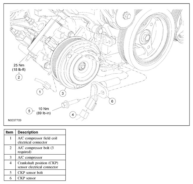

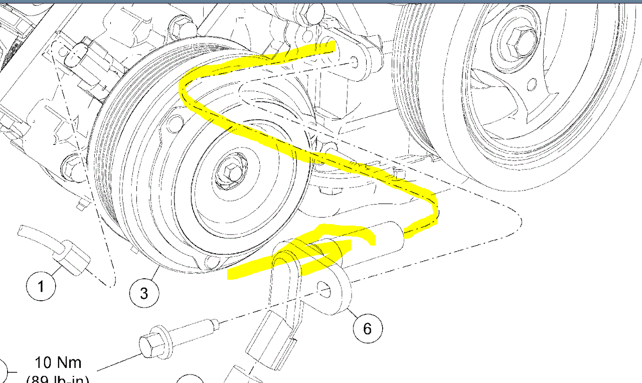

It's on the right side of the engine between the crank and AC compressor. See pic 1.

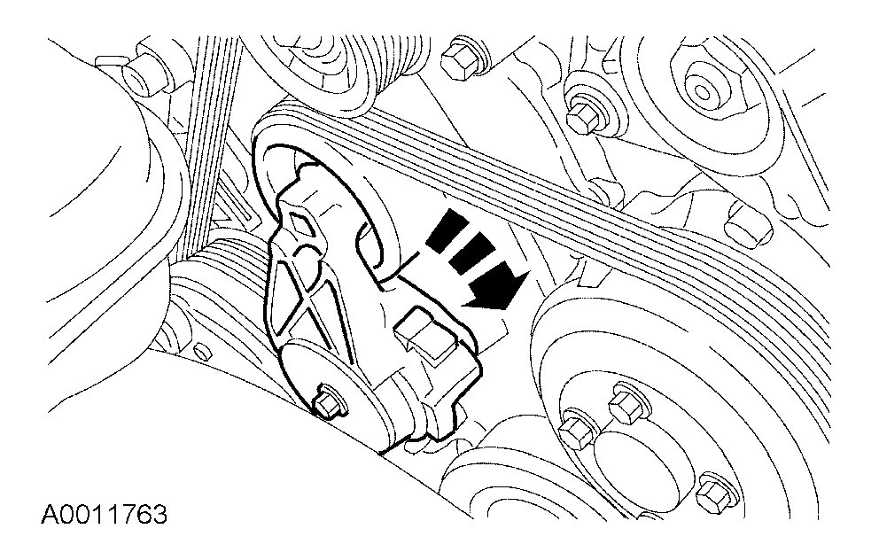

3. Rotate the tensioner and remove the drive belt from the A/C compressor pulley.

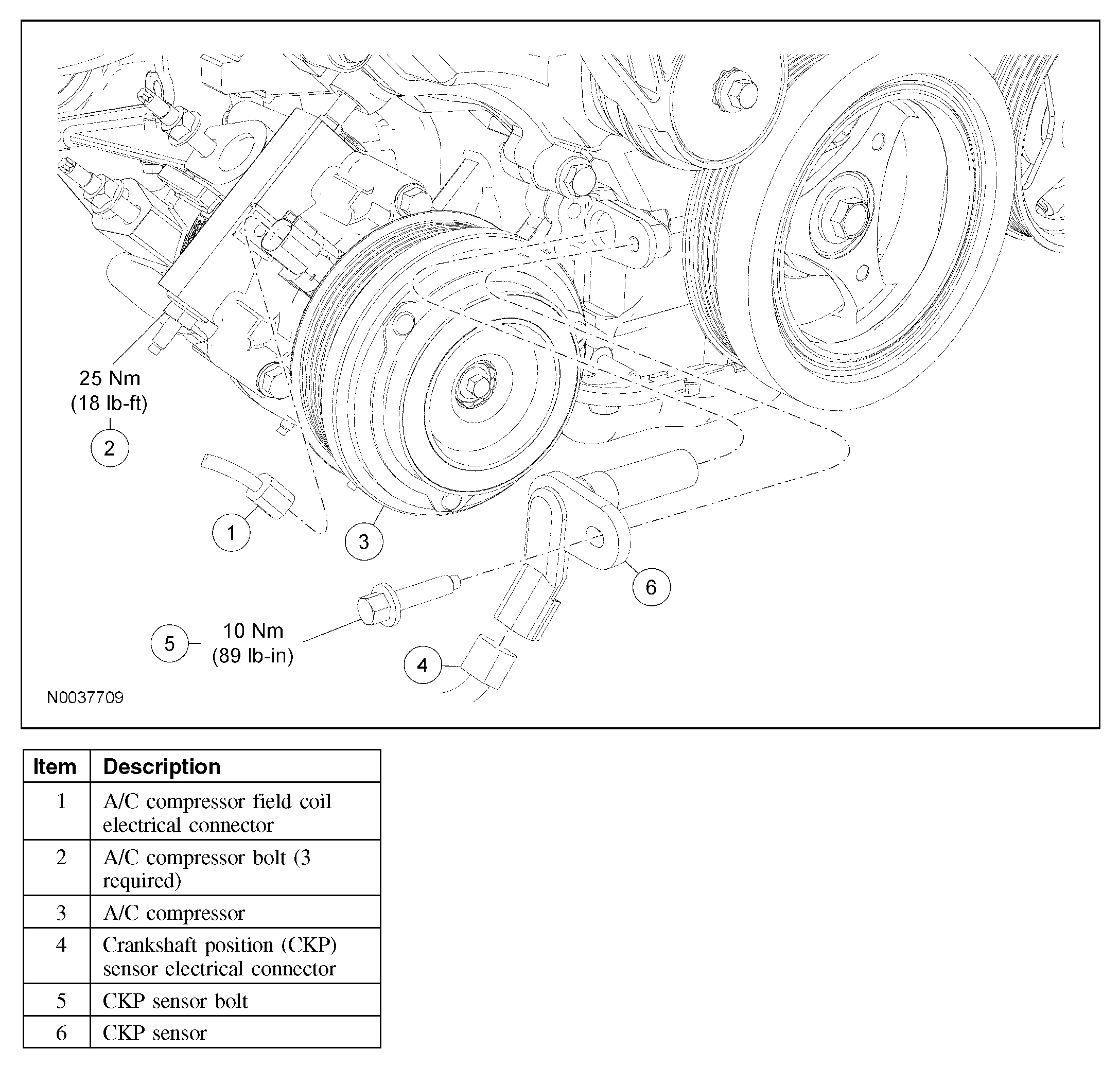

4. Disconnect the A/C compressor field coil electrical connector.
5. Disconnect the crankshaft position sensor (CKP) sensor electrical connector.

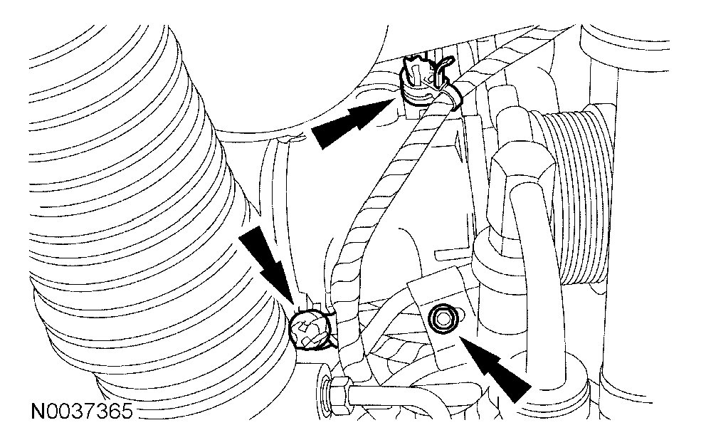

6. Remove the nut and detach the wiring harness clips.
- To install, tighten to 9 Nm (80 lb-in).

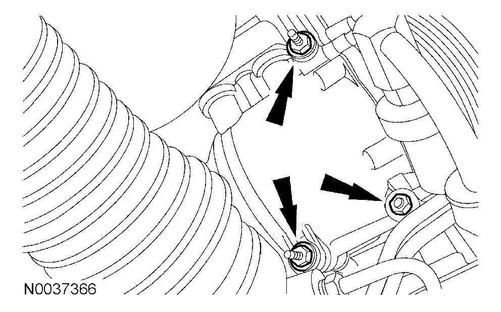

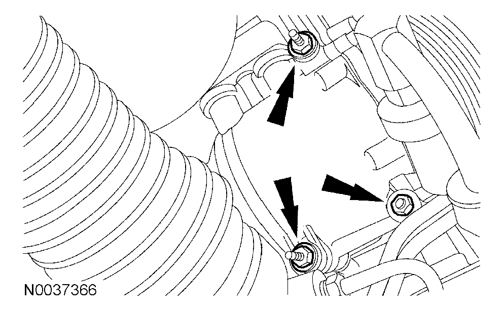

7. NOTE: It is not necessary to remove the A/C compressor bolts.
Loosen the 3 A/C compressor bolts enough to slide the compressor down one inch, allowing access for CKP sensor removal.
- To install, tighten to 25 Nm (18 lb-ft).
8. Remove the CKP sensor bolt.
- To install, tighten to 10 Nm (89 lb-in).
9. Remove the CKP sensor.

Thank you very much, Joe. you saved me from crawling around on my back trying to find it in my gravel driveway.
