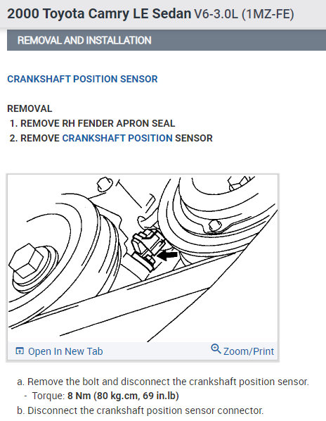

Need tutorial on how to replace it myself.

Here is the information you requested. Here is a tutorial for you to view on how to replace a crankshaft position sensor:
I've attached a couple picture steps below on how to replace the crankshaft position sensor and its location on your car. Hope this helps and thanks for using 2CarPros.
