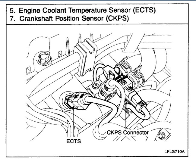

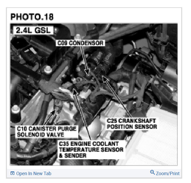

I have a dtc for the crankshaft position sensor. I have a 2006 body but have installed a engine from a 2008 Kia Optima 2.4. My question is, where is the exact location for the crankshaft position sensor on the vehicle listed above?
Apr 3, 2021 at 1:50 AM
  • 55,694 POSTS
Here is a guide to help you step by step with instructions in the diagrams below to show you how on your car:

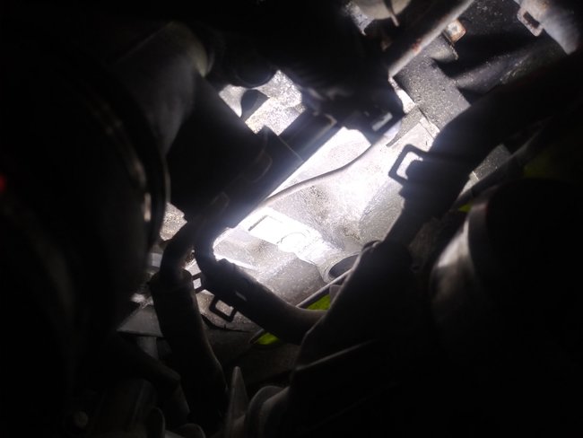

I removed the starter motor and I didn't see the sensor there unless i'm totally blind. Enclosed is a photo of behind the starter motor. Looking down from top of engine.
Apr 4, 2021 at 11:43 AM
  • 55,694 POSTS
I can't see the sensor. Can we double check the year of the car to make sure it is a 2008? Please post your new question here, you must be logged in.

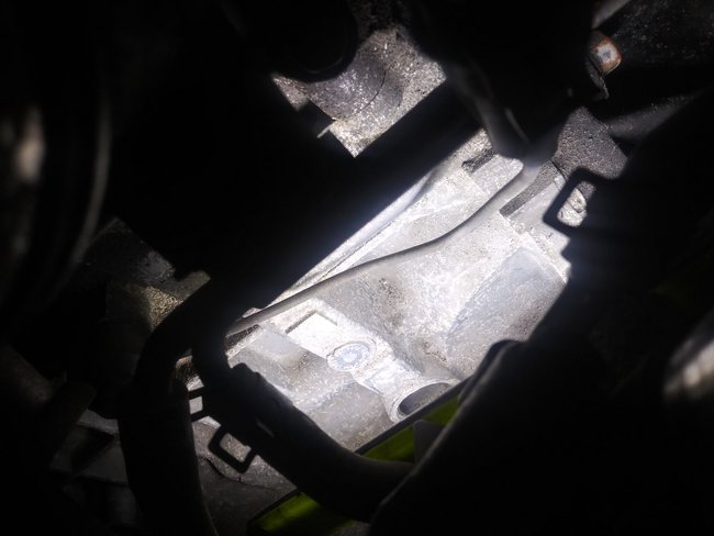

Update: i believe i found it. On back of engine between tranny and engine. It had a dust cover oner it with 3 bolts . please see attached photo.
Apr 5, 2021 at 5:08 AM
  • 55,694 POSTS
yep, that looks like it good find let me know how it goes when you install a the new sensor.
