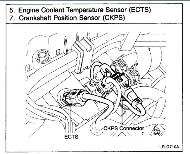

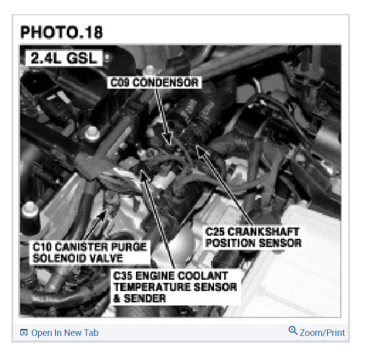

Here is a guide to help you step by step with instructions in the diagrams below to show you how on your car:

Thank you. I was about to pull the timing belt cover to change sensor. YouTube video said that's where it's located.

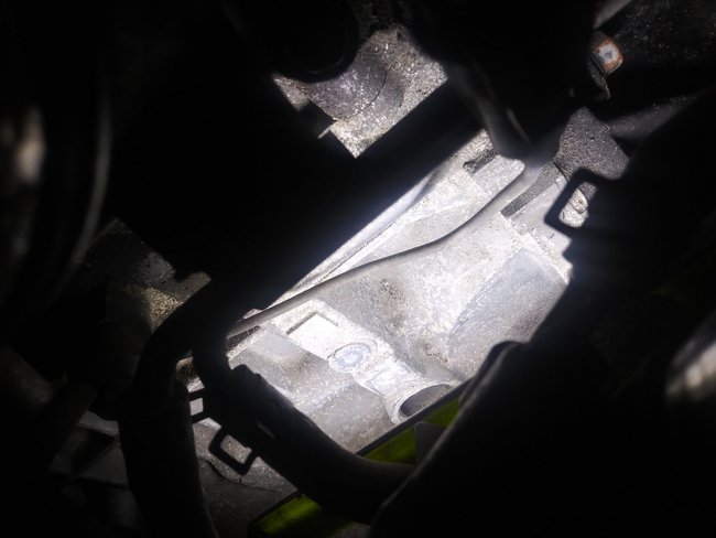

I removed the starter motor and I didn't see the sensor there unless i'm totally blind. Enclosed is a photo of behind the starter motor. Looking down from top of engine.
Apr 4, 2021 at 11:43 AM
  • 55,423 POSTS
I can't see the sensor. Can we double check the year of the car to make sure it is a 2008? Please post your new question here, you must be logged in.

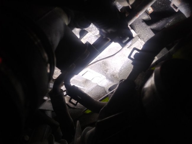

Update: i believe i found it. On back of engine between tranny and engine. It had a dust cover oner it with 3 bolts . please see attached photo.
Apr 5, 2021 at 5:08 AM
  • 55,423 POSTS
yep, that looks like it good find let me know how it goes when you install a the new sensor.

Changed sensor. Didnt solve problem. Started looking around and pulled the variable valve timing sensor. Bingo. It was stuck closed. Installed new sponsor. Car runs excellent now.
