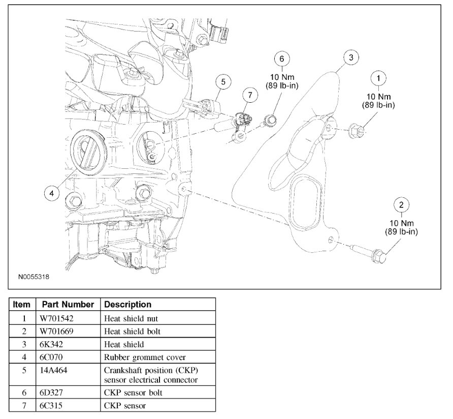

I need to know where the crankshaft position sensor is located to replace on my car listed above SEL model.

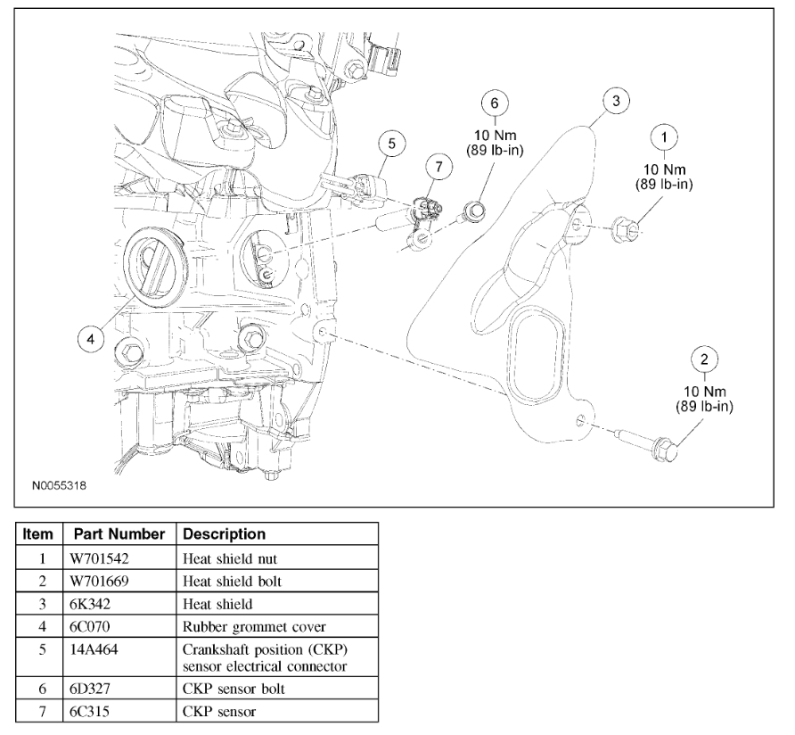

Oh man, there is an access port and heat shield involved. The crankshaft sensor is on the left side of the engine near the bell housing. Here is a diagram to help. Check out the images (below). Let us know if you need anything else.
