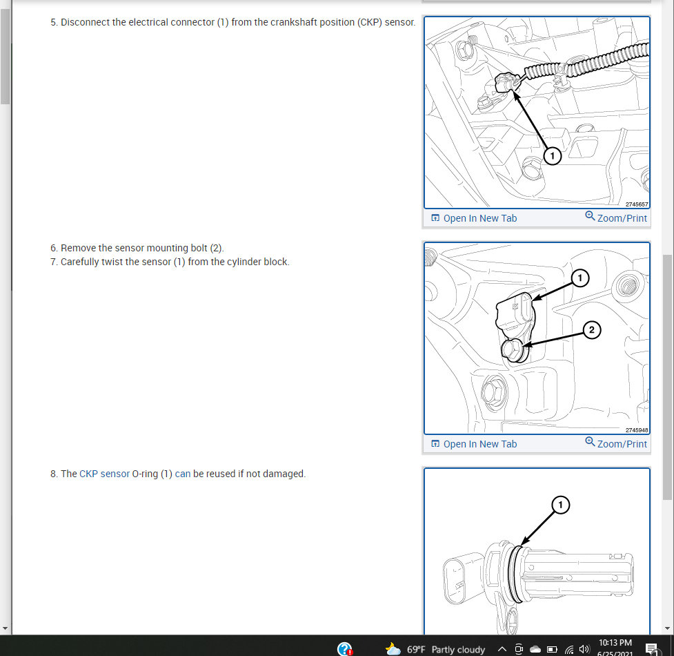

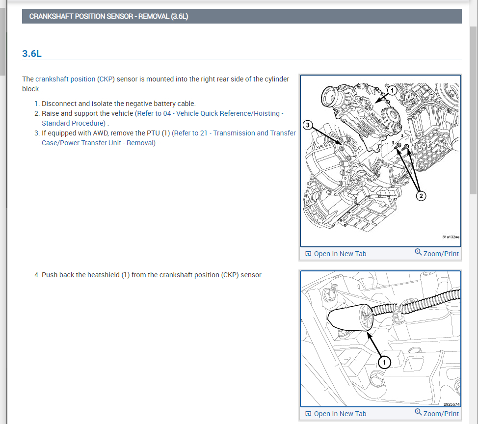

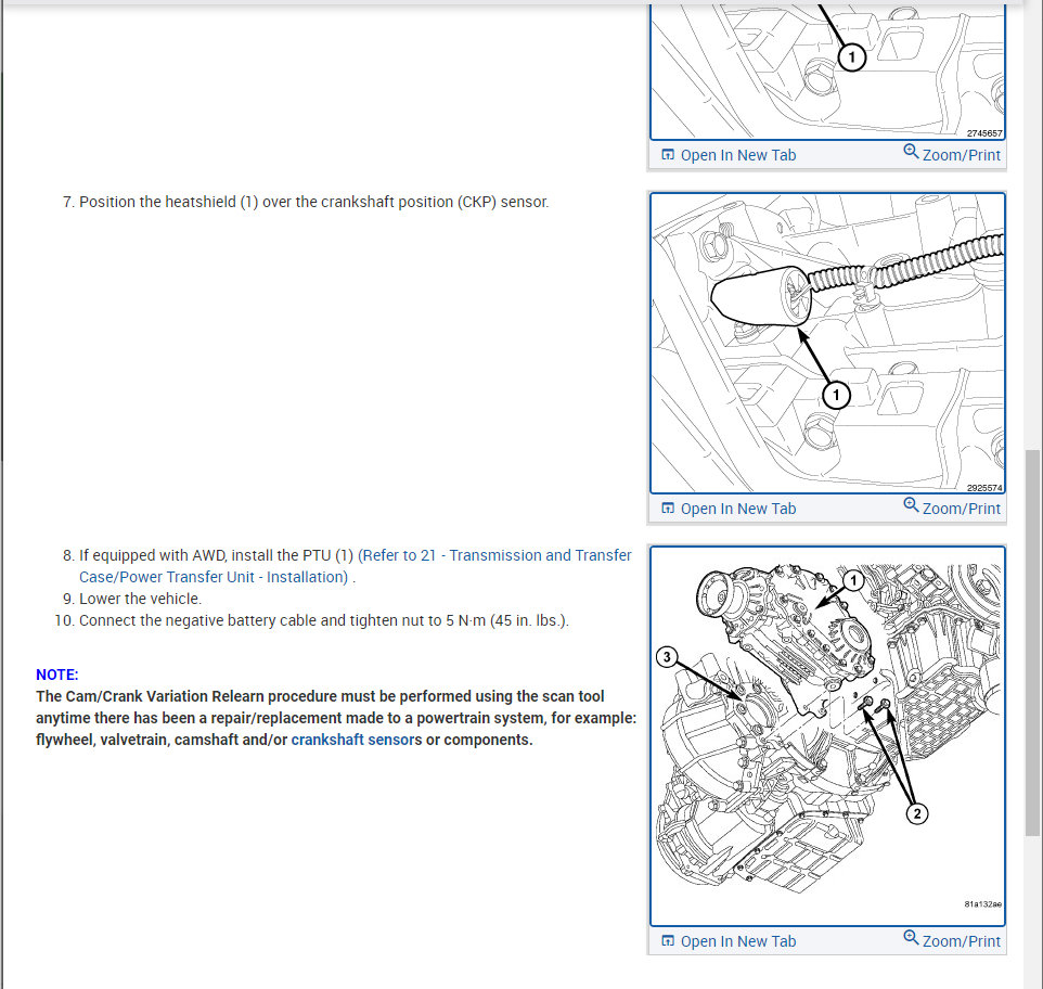

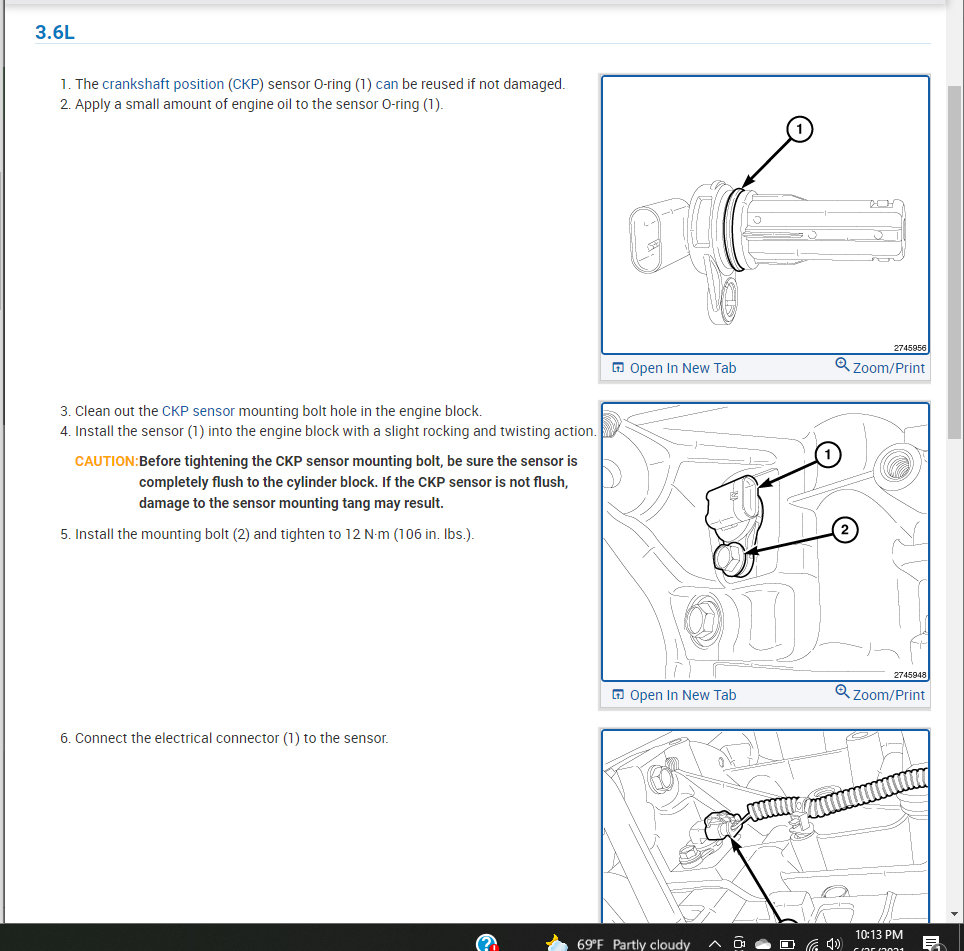

Below is the process on how to replace the crank sensor from the manual if this is what it proves to be the issue.
