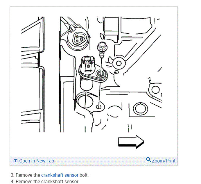

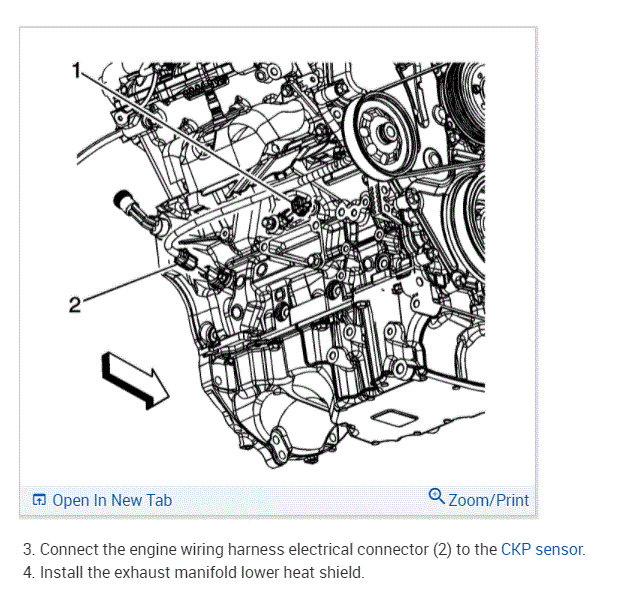

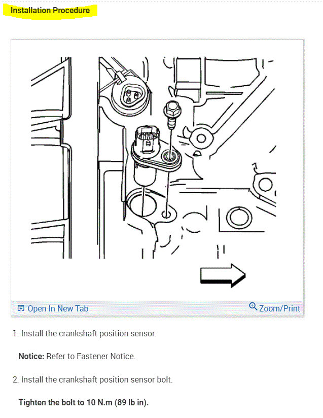

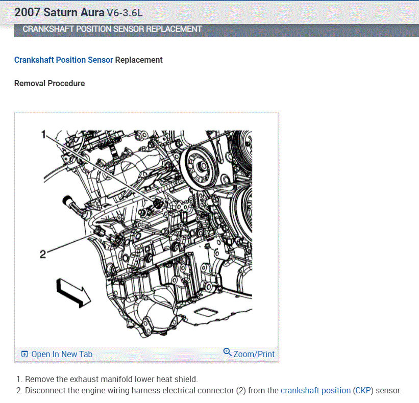

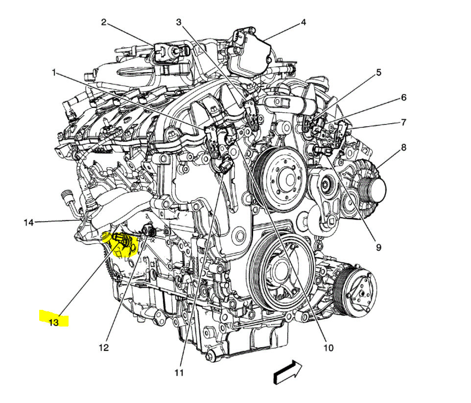

Where is the cps located on the car listed above xr 3.6?
Jan 10, 2022 at 12:58 AM
  • 110,240 POSTS
The crankshaft position sensor is on the side of the engine facing the firewall. It's near the transmission and behind the exhaust manifold on that side.
Pic 1 shows the location of the sensor. The remaining pics are the directions specific to your vehicle for replacing the sensor. Additionally, here is a link that explains in general how one is replaced. You can use it to help guide you.
