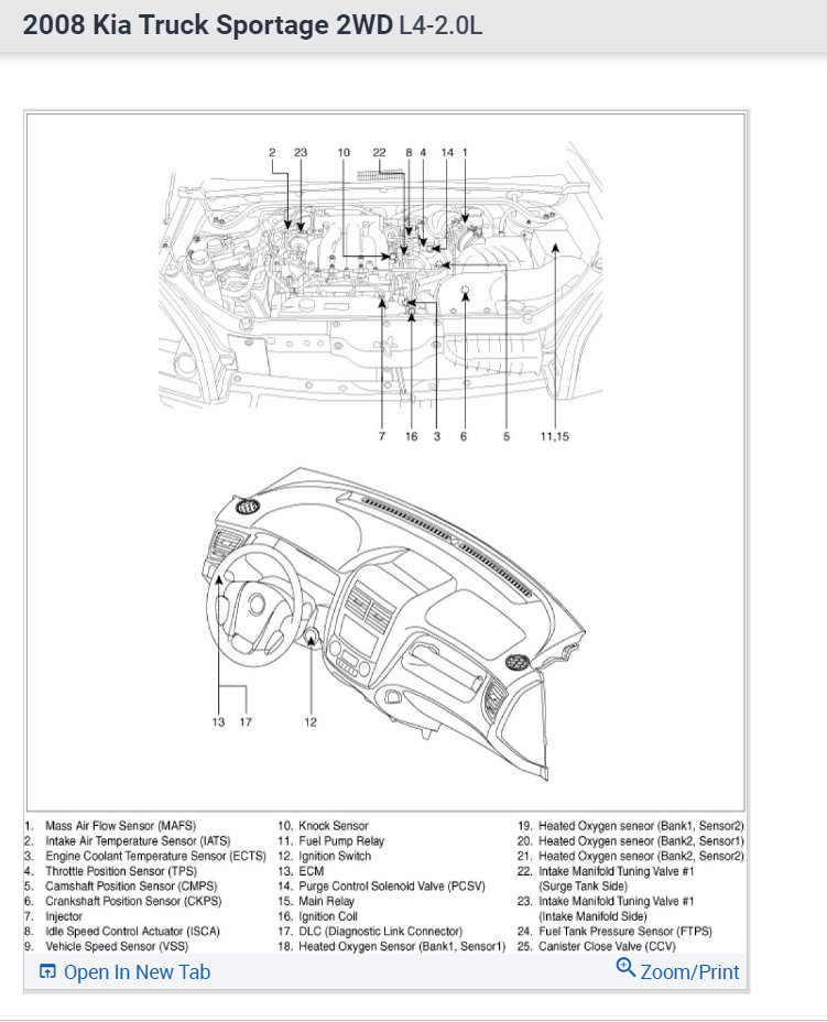

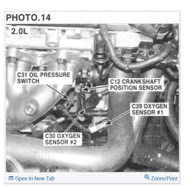

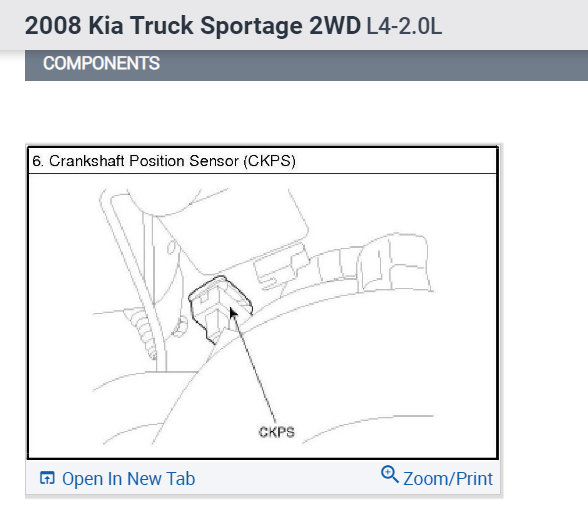

Where is the Crankshaft position sensor located?
150,000 MILES • 4 CYL • AUTOMATIC
HANNAH2015
It won't start, engine will turn over though, ticking noise and exhaust issues.
Sep 30, 2022 at 10:27 PM
  • 55,865 POSTS
The crankshaft position sensor is near the radiator hoses., here is the exact location and how to change it out in the images below. Check out the images (below). Please let us know if you need anything else to get the problem fixed.
