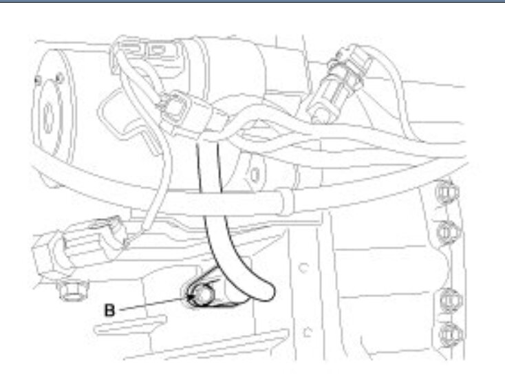

Where is the Crankshaft position sensor located?
2014 HYUNDAI TUCSON
84,000 MILES • 0.6L • V6 • 2WD • AUTOMATIC
OZIAS LEVI ISRAEL
In a 2014 Hyundai Tucson on the Hyundai nu engine (DOHC engine).
Nov 24, 2022 at 6:36 AM
  • 110,241 POSTS

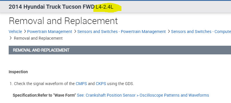

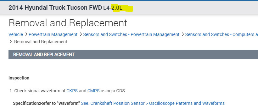

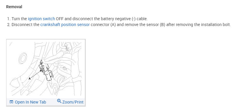

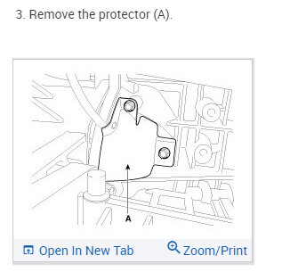

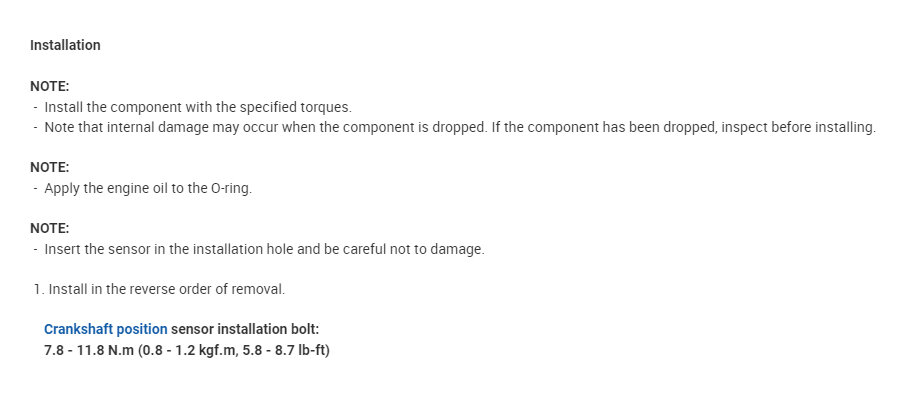

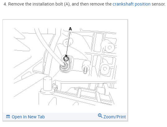

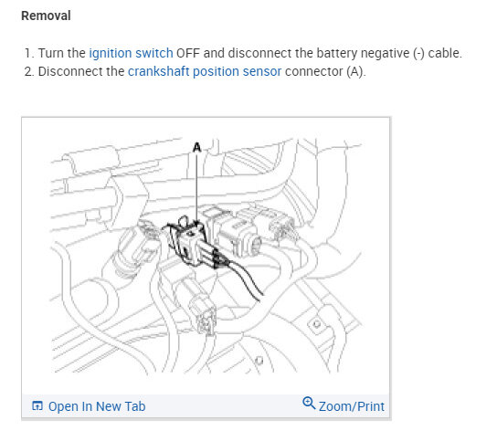

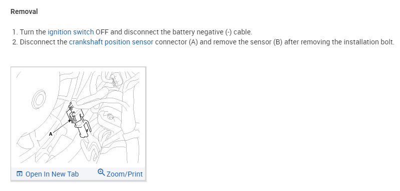

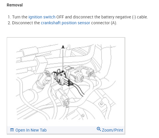

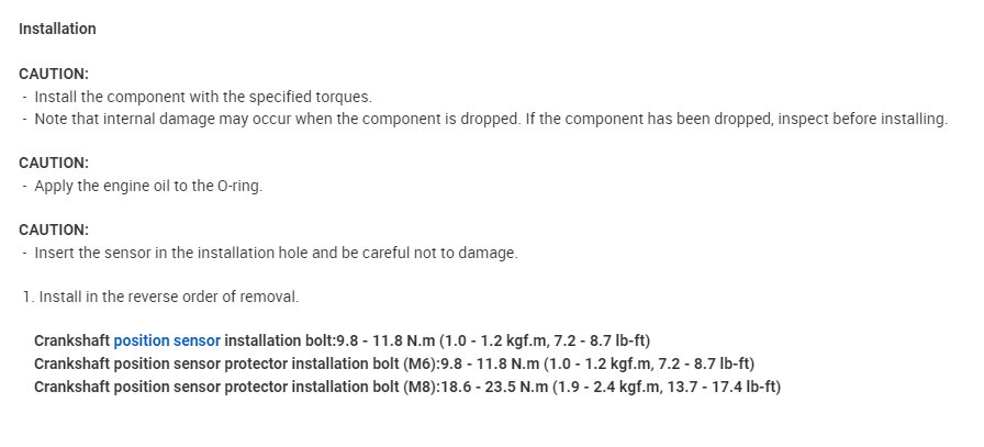

I am only showing a 2.0L or a 2.4L four-cylinder engine as options. The 2.0L is below the starter motor and the 2.4L is at the rear of the engine block near the transmission bell housing.
I attached directions for both engines below. I highlighted the engine size at the start of each procedure.

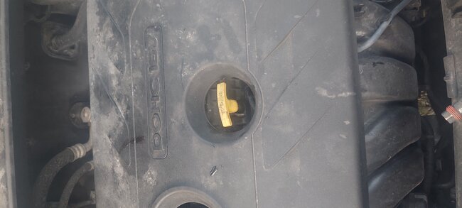

OZIAS LEVI ISRAEL
Sorry, it's a 16v engine.
