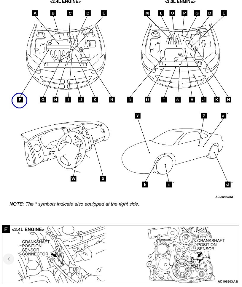

Where is the crankshaft position sensor located?
2005 CHRYSLER SEBRING
111,100 MILES • 2.4L • 4 CYL • AUTOMATIC
DUBYEKOMS
Can't find location of sensor.

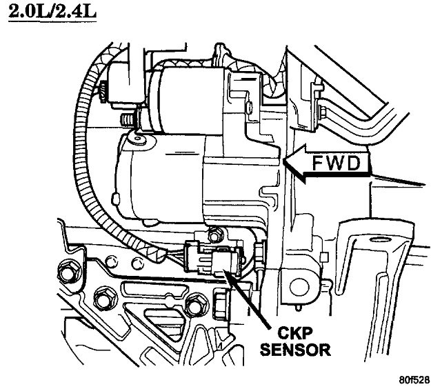

The first drawing is for the Sedan. The second one is for the Coupe. If you have a convertible, use the first drawing. Check out the diagrams (Below). Let us know what happens and please upload pictures or videos of the problem.
