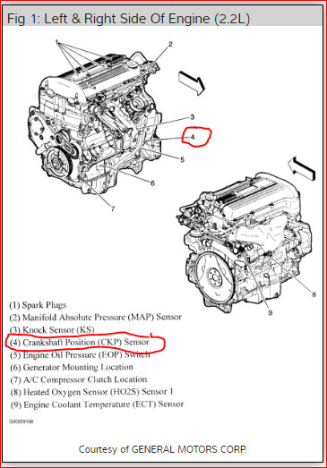

I need the location of the crankshaft position sensor.

I have attached a picture of the location on the engine and circled in red. Hope this helps and please feel free to ask any further questions if needed.. Thanks for using 2CarPros.com. Danny-
