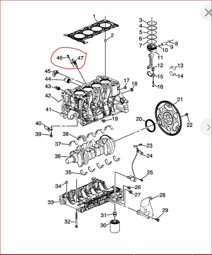

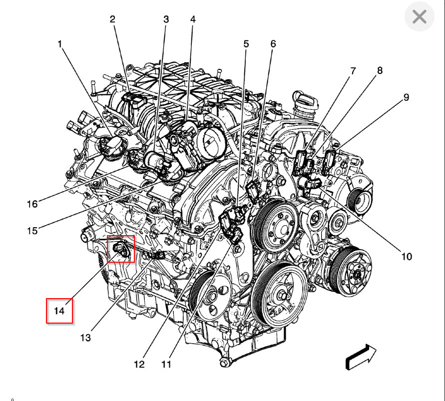

Where is crankshaft position sensor located on 2014 impala LT 2.5L (new body) Thanks
May 16, 2019 at 11:05 AM
Hi Hayderaz,
I attached an exploded view of the engine block and it shows the crank sensor location. I circled it in red just in case.
Please let me know if you need anything else. Thanks
May 16, 2019 at 12:11 PM
HAYDERAZ
Thank you for your help but I did not find it. do you mean I need to open the engine ?
May 17, 2019 at 2:44 AM
No. that was the only view that they gave in the shop manual to show where it is located. However, I didn't think to look at the replacement procedure. Here is a different view. Looks like it is behind the exhaust pipe on the side of the engine block.

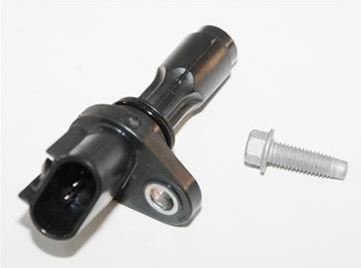

STEVE W.
  • 15,423 POSTS
The GM part number for the crank sensor on that engine is GM# 12598208 it is the one in the image. The part number you have (10456568) is the transmission output speed sensor. The crank position sensor is on the firewall side of the engine, just above the oil pan lip and in line with the exhaust outlet on the manifold. To get to it you go under the car, then unplug the sensor, remove it and reverse the process to install the new one. They have a habit of sticking in the block so you may want to remove it with a warm engine and gently work it out of the bore.
Once replaced you need to use a scan tool to do a CKP relearn procedure so the ECM knows the signal levels of the new sensor.

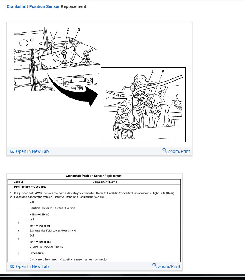

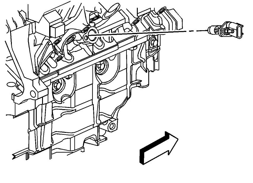

I don't know where the crankshaft position sensor is located on my car listed above SS model.
Mar 17, 2021 at 10:12 AM (Merged)
Take a look at this information. This is the location and replacement information. Let us know what other info you need. Check out the diagrams (Below). Please let us know if you need anything else to get the problem fixed. Thanks

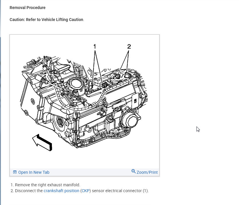

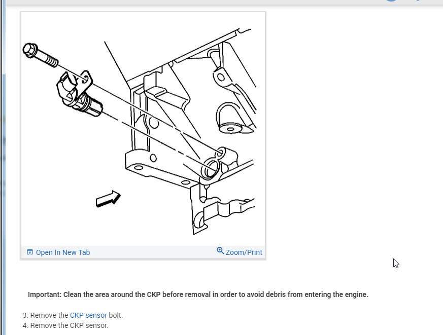

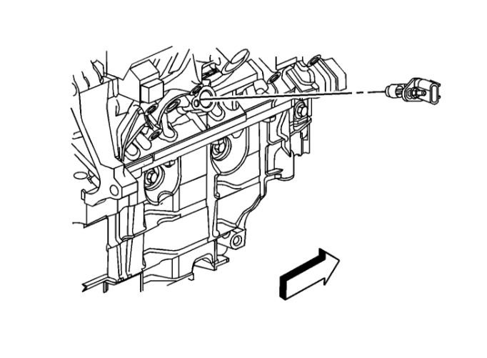

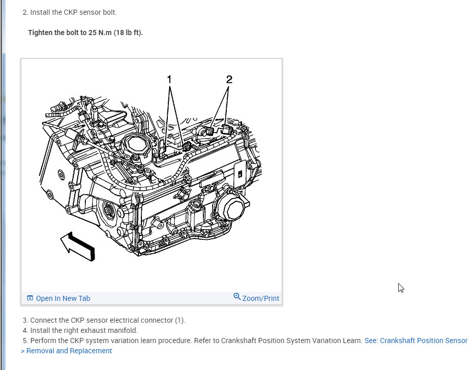

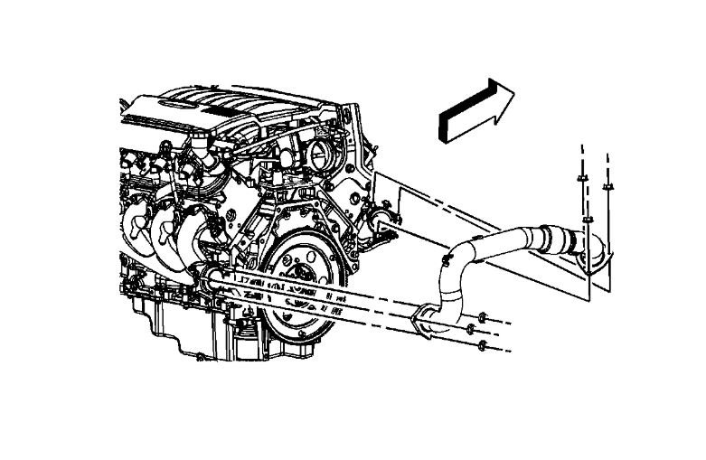

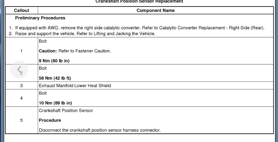

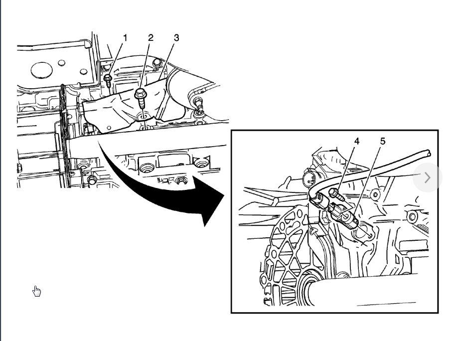

MATTHEW MCDOWELL
Cannot find the crankshaft position sensor.
Mar 17, 2021 at 10:13 AM (Merged)
Good evening.
The crank sensor is behind the right exhaust manifold. The manifold needs to be removed to gain access to the sensor.
Removal Procedure
Caution: Refer to Vehicle Lifting Caution in Service Precautions.
1. Remove the right exhaust manifold.
2. Disconnect the crankshaft position (CKP) sensor electrical connector (1).
Important: Clean the area around the CKP before removal in order to avoid debris from entering the engine.
3. Remove the CKP sensor bolt.
4. Remove the CKP sensor.

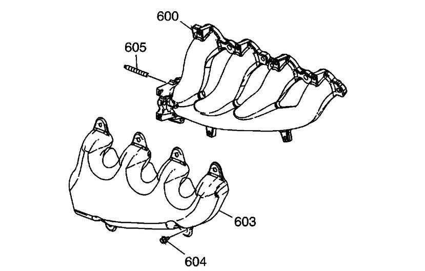

right manifold
1. Remove the engine sight shield.
2. Remove the spark plugs.
3. Remove the exhaust crossover pipe nuts from the right exhaust manifold.
4. Disconnect the catalytic converter from the exhaust manifold.
5. Support the catalytic convertor and exhaust system with the mechanics wire.
6. Lower the vehicle.
7. Remove the ignition coil.
8. Remove the O2 sensors.

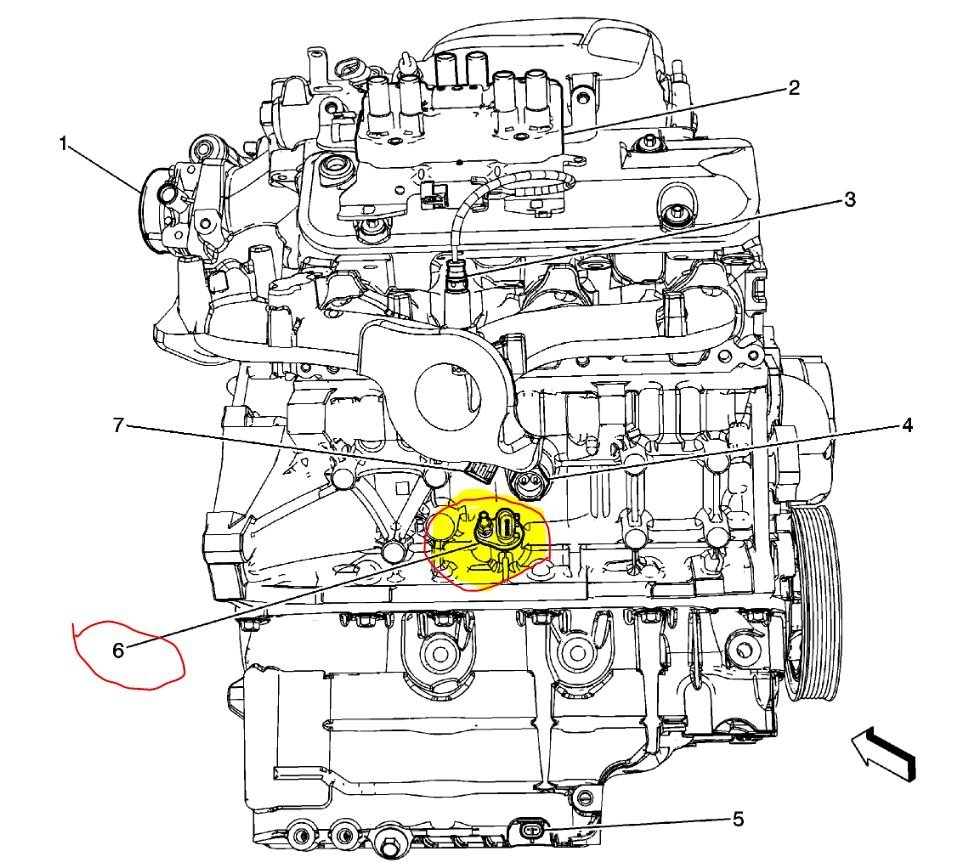

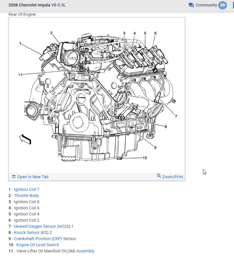

HERSHEY81
Need help locating CPS. code P0336 pops up.
Mar 17, 2021 at 10:14 AM (Merged)

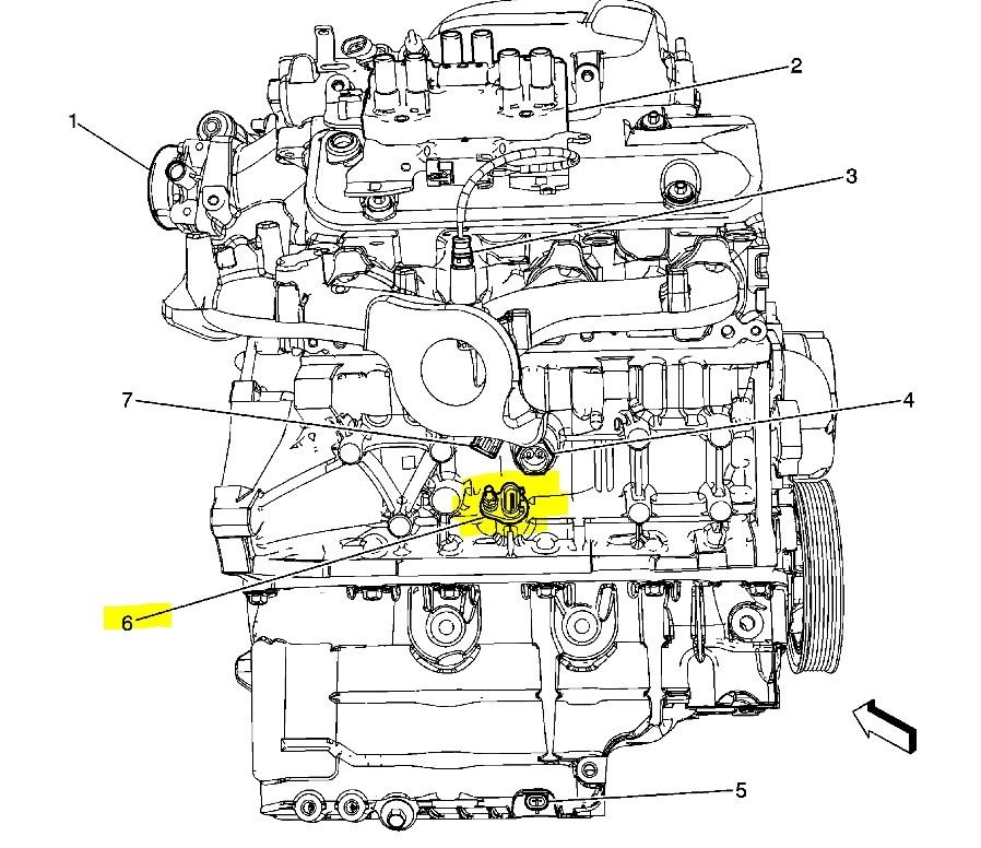

AL514
  • 5,704 POSTS
Hello, thanks for using 2CarPros. here is a diagram locating the crank position sensor. It is located under the exhaust manifold about half way back on the engine block.
https://www.2carpros.com/articles/how-a-crank-shaft-angle-sensor-works

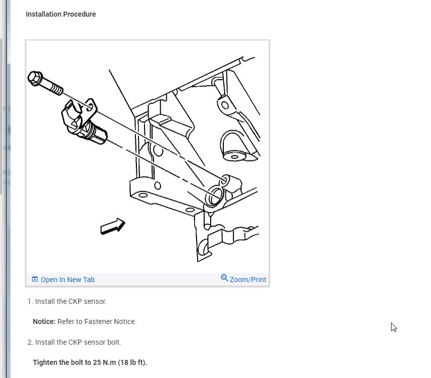

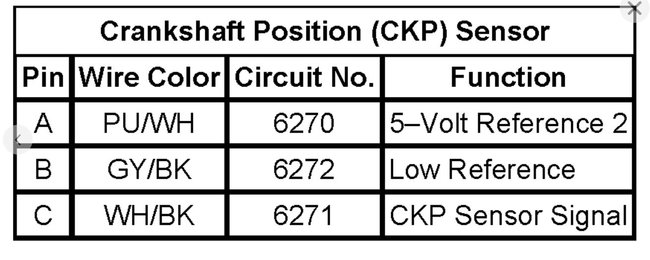

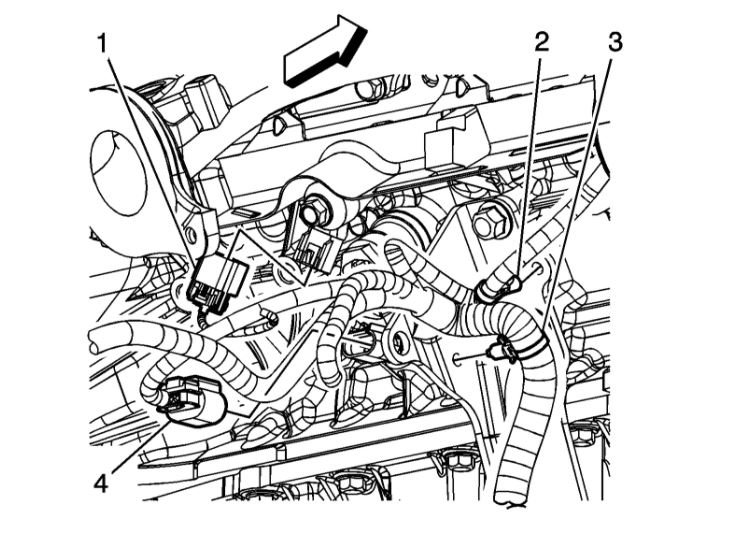

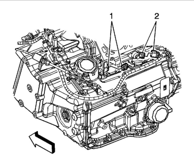

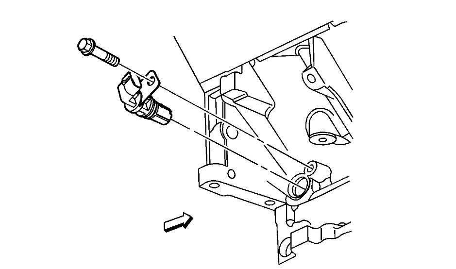

GREG STONE

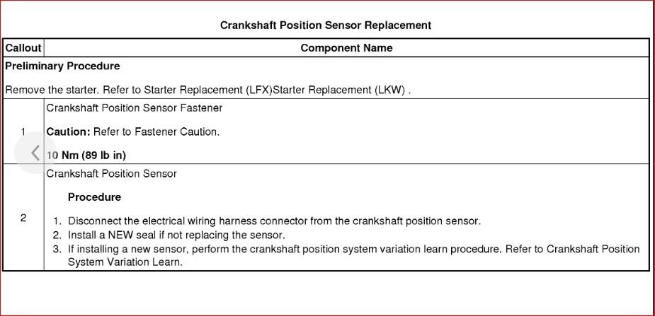

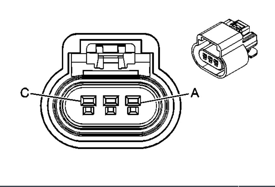

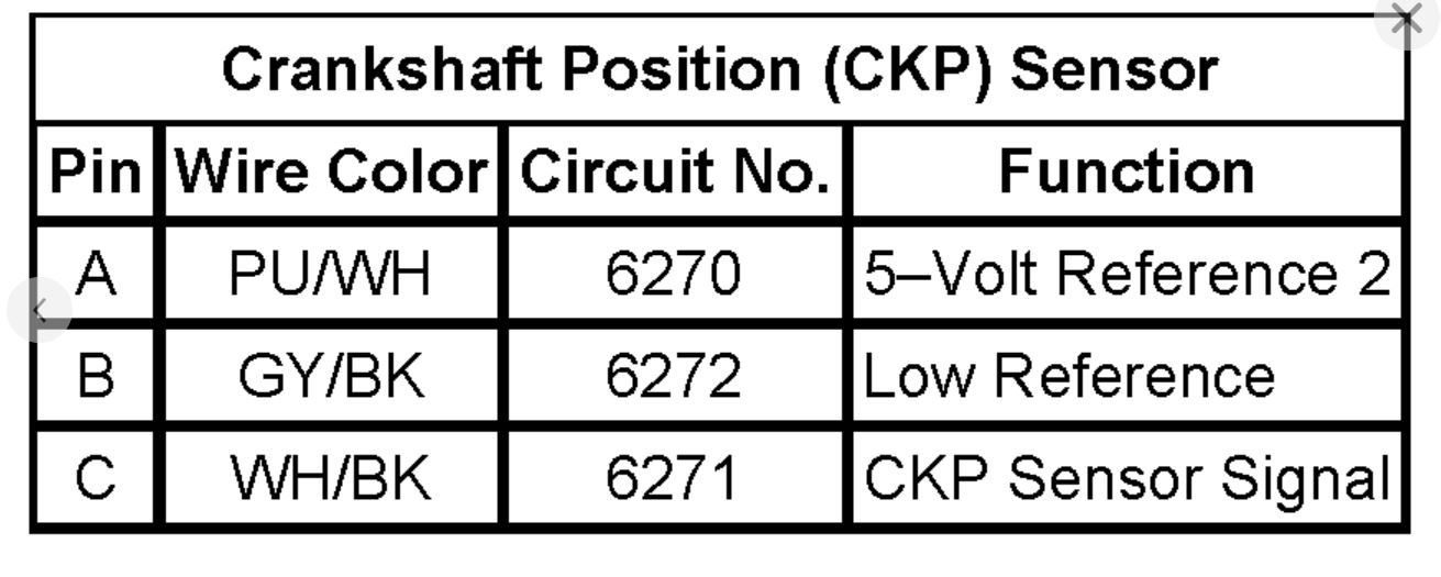

Had new computer and fuse box installed went and got new crank sensor, my buddy went to put in and cut off connector and don't think he wired them back right. need to know what color goes to what. still no RPMs and idle very rough won't throttle up.

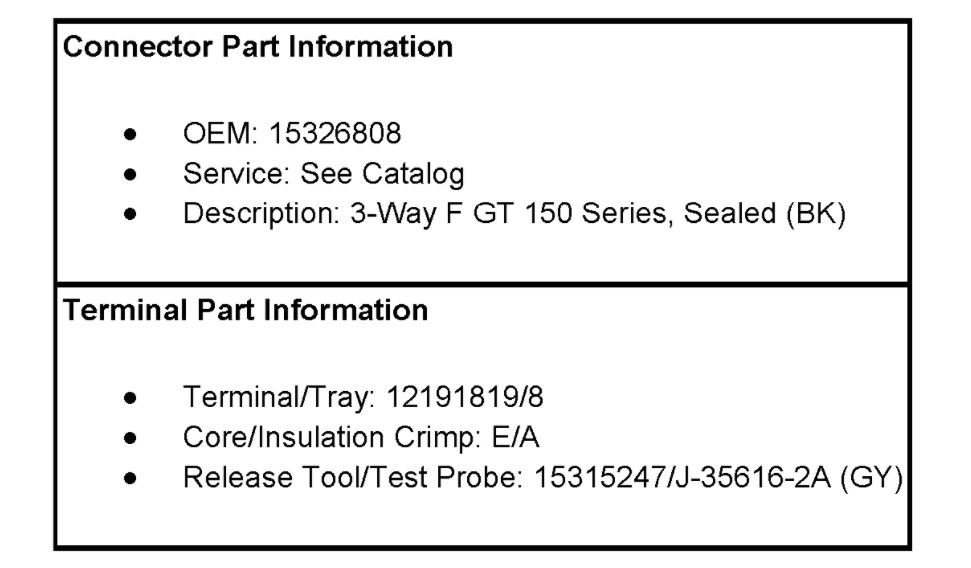

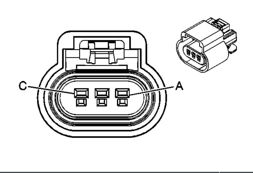

Good morning,
I attached the connector view for you below with the terminal identifications.
Crankshaft Position Sensor Replacement
Removal Procedure
1. Raise and support the vehicle. Refer to Vehicle Lifting.
2. Disconnect the crankshaft position (CKP) sensor electrical connector (4).
3. Remove the CKP sensor stud.

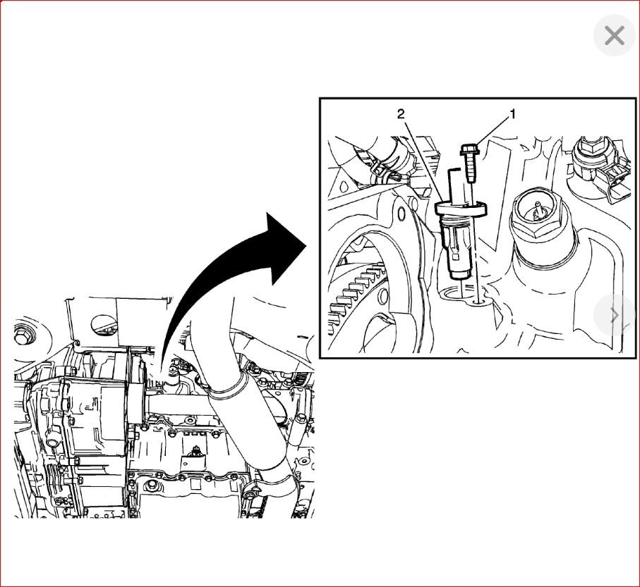

BMAN91
Where exactly is the crank shaft position sensor located on the listed above it is the SS model.
  • 55,857 POSTS
Here is a guide that will show you what you are in for when doing the job:
Here is the location for your car.

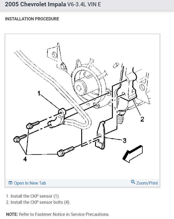

FORTEJETS18

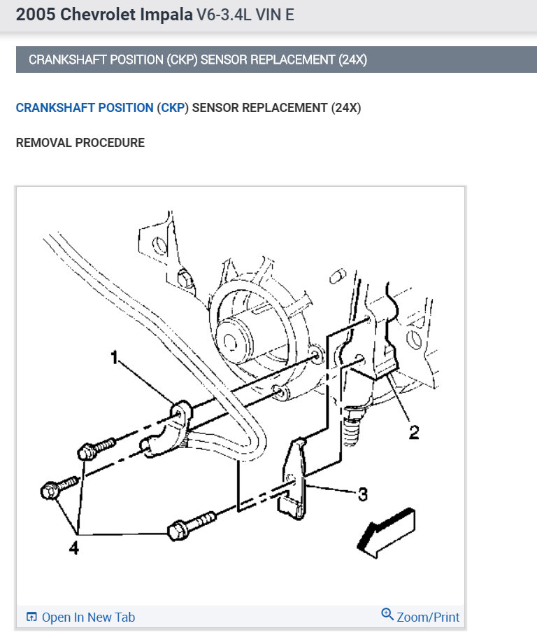

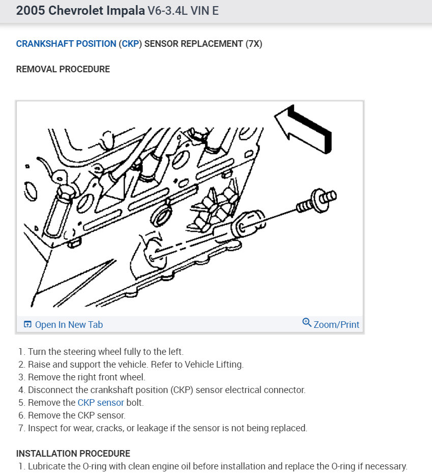

My car has a bad Crankshaft position sensor. It's a 2005 chevy impala, 3.4 and I know there are two possible places where it could be. Can you tell me the exact place they would be located?

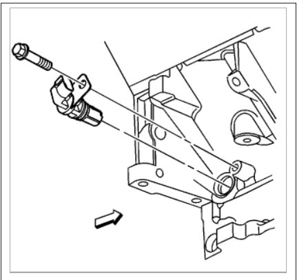

JDL
  • 16,098 POSTS
There are two crankshaft position sensors on this car one at the front of the crankshaft and the other on the side of the block which will need to have a relearn which I have included as well.
this guide will walk you through the steps with the instructions on how to change the sensor for your car below.

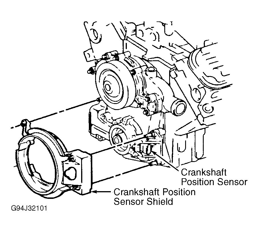

PATENTED_REPAIR_PRO
  • 1,853 POSTS
Removal (3.8L)
1.Turn OFF the ignition. Disconnect the negative battery cable. Remove the drive belt. Raise and support the vehicle. Remove the right front tire and wheel. Remove the right engine splash shield retainers and the engine splash shield. Remove the torque converter cover. Install the Flywheel Holder (J-37096) to hold the flywheel.
CAUTION: Do not separate the crankshaft pulley from the crankshaft balancer. Service the crankshaft pulley and the crankshaft balancer as an assembly.
2.Remove the crankshaft balancer retaining bolt. Install the Crankshaft Balancer Remover (J-38197-A). Remove the crankshaft balancer. Remove the crankshaft balancer remover. Disconnect the Crankshaft Position (CKP) sensor electrical connector. Remove the CKP sensor shield. See Fig 3. DO NOT use a pry bar. Remove the CKP sensor studs. Remove the CKP sensor.
Fig 3: Removing Crankshaft Position Sensor Shield (3.8L)
Installation
1.Install the CKP sensor. Install the CKP sensor studs. Tighten the studs to specification. See TORQUE SPECIFICATIONS . Install the CKP sensor shield. Connect the CKP sensor electrical connector.
2.Coat the engine front cover seal contact area on the crankshaft balancer, and the seal surface with clean engine oil. Install the crankshaft balancer. Install the crankshaft balancer retaining bolt. Use the Flywheel Holder (J-37096) to keep the flywheel from turning. Tighten the crankshaft balancer bolt to specification.
3.Remove the flywheel holder. Install the torque converter cover. Install the right engine splash shield and the engine splash shield retainers. Install the right front tire and wheel. Lower the vehicle. Install the drive belt. Reconnect the negative battery cable. Perform the CKP System Variation Learn Procedure. See COMPUTER RELEARN PROCEDURES article in GENERAL INFORMATION.

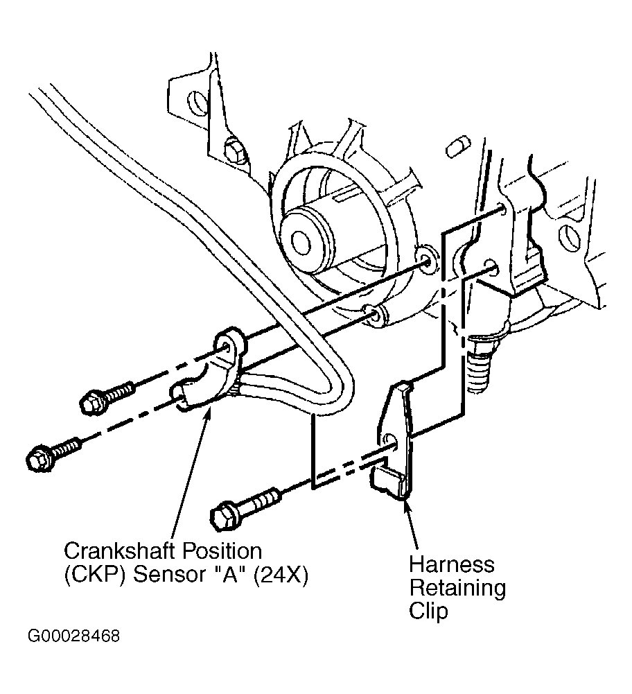

  • 1,853 POSTS
This is that crank sensor replacement instructions,
CRANKSHAFT POSITION SENSOR
Removal (3.1L & 3.4L - CKP Sensor "A")
Crankshaft Position (CKP) sensor "A" may also be referred to as CKP sensor 24X. CKP sensor is located behind the crankshaft balancer. See Fig 1. Turn OFF the ignition. Remove the drive belt. Raise and support the vehicle. Remove the lower air deflector. Disconnect the CKP sensor harness connector.
Remove the crankshaft balancer bolt. Using Crankshaft Balancer Puller (J-24420-C), remove the crankshaft balancer. Note the routing of the CKP sensor harness before removal. Remove the harness retaining clip and bolt. Disconnect the CKP sensor electrical connector. Remove the sensor bolts. Remove the CKP sensor.
Installation
Install the CKP sensor with bolts and the route harness as noted during removal. Install the harness retaining clip and bolt. Tighten the bolts to specification. See TORQUE SPECIFICATIONS .
Connect the CKP sensor electrical connector. Apply Sealer (12345739) or the equivalent to the keyway of the crankshaft balancer. Install the crankshaft balancer into position over the key in the crankshaft. Using Crankshaft Balancer Installer (J-29113), install the crankshaft balancer to the crankshaft.
Remove the crankshaft balancer installer from the crankshaft balancer. Install the crankshaft balancer washer and the crankshaft balancer bolt. Tighten the bolt to specification.
Install the lower air deflector. Lower the vehicle. Install the drive belt. Perform the CKP System Variation Learn Procedure. See COMPUTER RELEARN PROCEDURES article in GENERAL INFORMATION.
Fig 1: Locating Crankshaft Position Sensor "A" (3.1L & 3.4L)
G00028468
Courtesy of GENERAL MOTORS CORP.

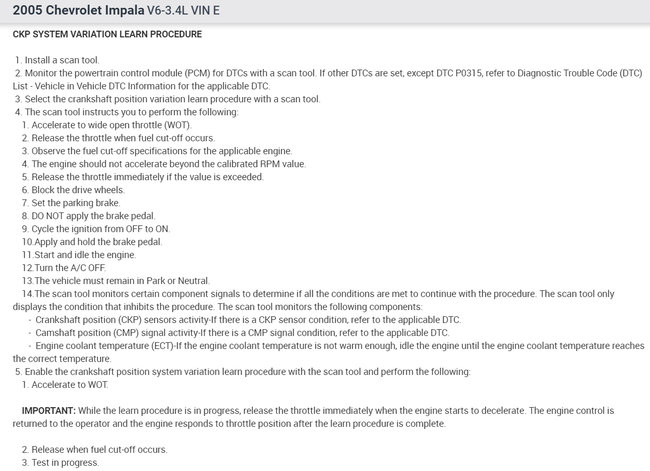

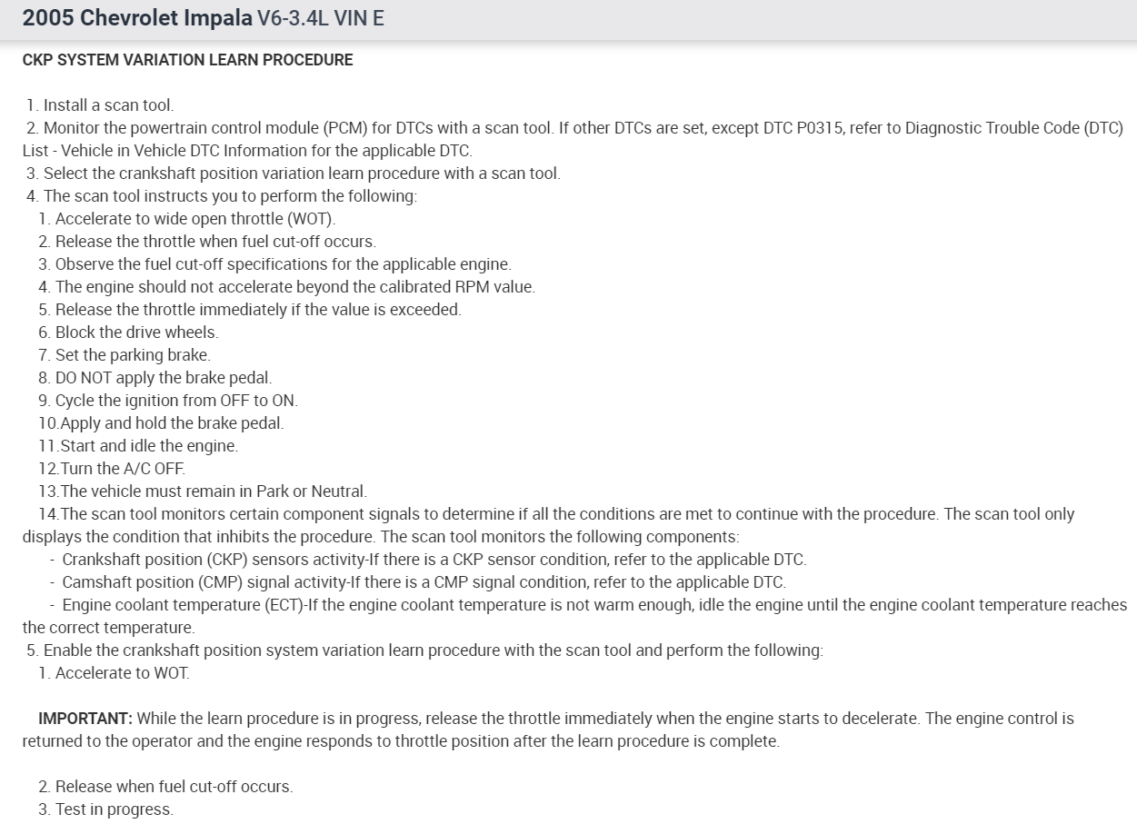

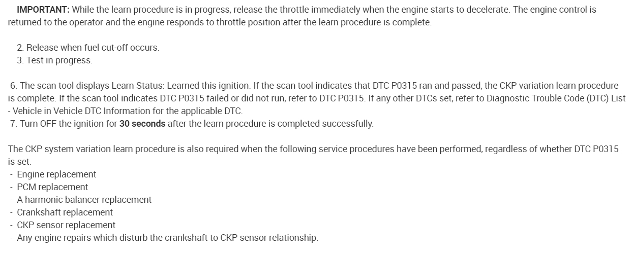

Hi on the 3.4L I don't understand about relearn procedure I didn't do a relearn when I put the sensor in the block could that be why I couldn't start it? Also I haven't gotten to the one under the balancer yet please help me understand what relearn means can you guide me please?
PATENTED_REPAIR_PRO
  • 1,853 POSTS
You will need a scan tool but here is the procedure.
As you can see the engine is running, so no this procedure if not done will not prevent the engine from running. I think you still have a security issue.
CAUTION: Before performing crankshaft position system variation learn procedure, always set parking brake and block drive wheels in order to prevent personal injury. Release throttle immediately when engine starts to decelerate in order to eliminate over-revving engine. Once learn procedure has been completed, control module will return engine control to operator and engine will respond to throttle position.
NOTE: Battery must be fully charged and in good condition. Scan tool connection at Data Link Connector (DLC) should be clean and tight before starting crankshaft position system variation learn procedure.
Install scan tool. Close hood.
With a scan tool, monitor the powertrain control module for DTCs. If other DTCs are set, except DTC P1336, diagnose affected DTC(s). See appropriate SELF-DIAGNOSTICS article.
With a scan tool, select the Crankshaft Position (CKP) variation learn procedure.
Observe the fuel cut-off for the engine that you are performing the learn procedure on.
The scan tool instructs you to perform the following:
Block drive wheels.
Apply parking brakes.
Cycle ignition from OFF to ON.
Apply and hold brake pedal.
Start and idle engine.
Turn OFF A/C.
Place transmission in Park (A/T) or Neutral (M/T).
The scan tool monitors certain component signals to determine if all the conditions are met to continue with the procedure. The scan tool only displays the condition that inhibits the procedure. The scan tool monitors the following components:
CKP sensor activity. If there is a CKP sensor condition, refer to the applicable DTC that set. See appropriate SELF-DIAGNOSTICS article.
CMP sensor activity. If there is a CMP sensor condition, refer to the applicable DTC that set. See appropriate SELF-DIAGNOSTICS article.
If ECT is not warm enough, idle engine until engine coolant temperature reaches correct temperature.
With the scan tool, enable the CKP system variation learn procedure.
NOTE: While learn procedure is in progress, release throttle immediately when engine starts to decelerate. The engine control is returned to operator and engine responds to throttle position after the learn procedure is complete.
Slowly increase the engine speed to the RPM that you observed.
Immediately release the throttle when fuel cut-off is reached.
The scan tool displays Learn Status: Learned this ignition. If scan tool does NOT display this message and no additional DTCs set, diagnose for an engine mechanical problem. If a DTC set, diagnose affected DTC(s). See appropriate SELF-DIAGNOSTICS article.
Turn ignition off for 30 seconds after the learn procedure is completed successfully.
