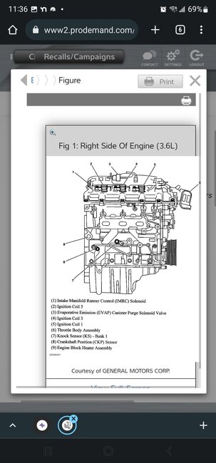

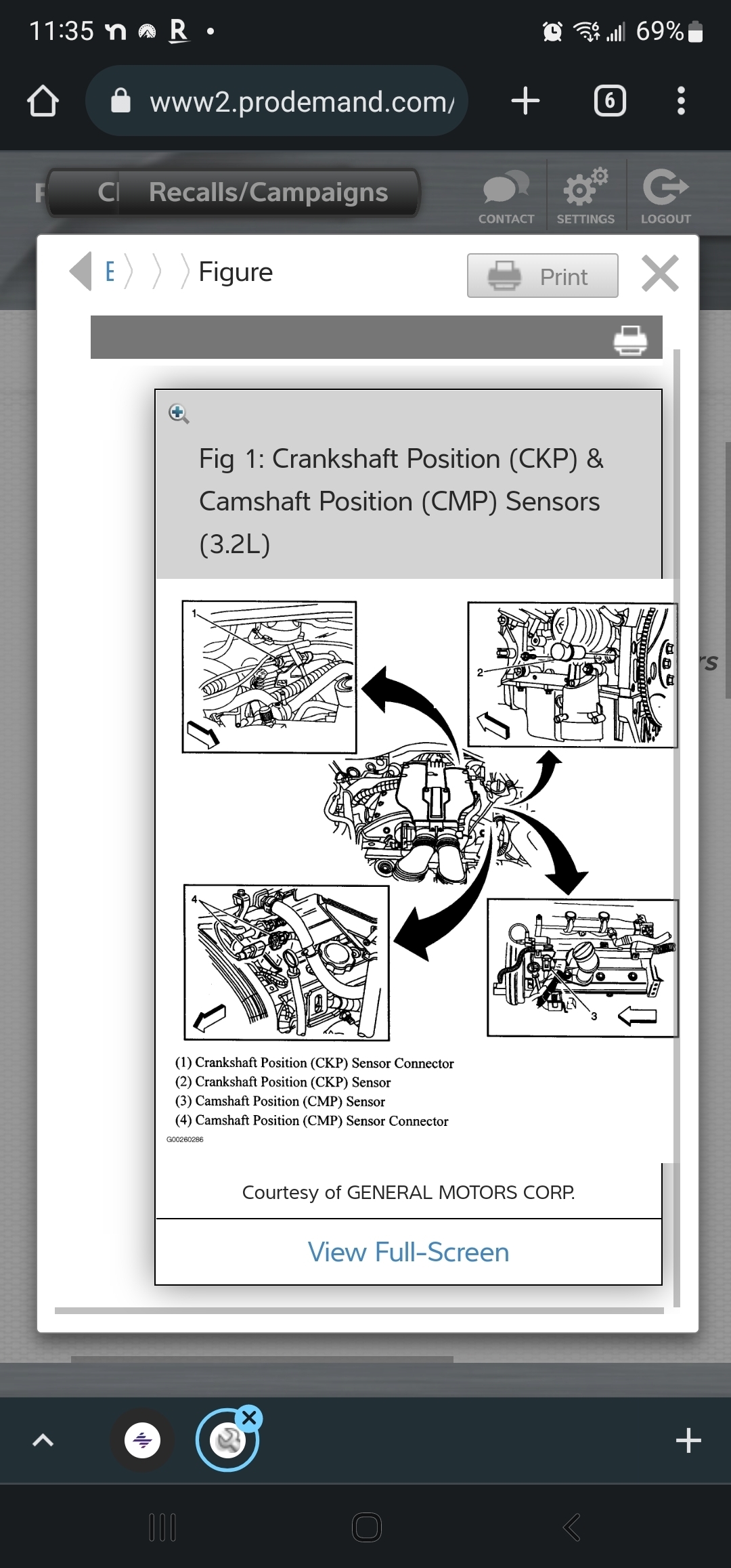

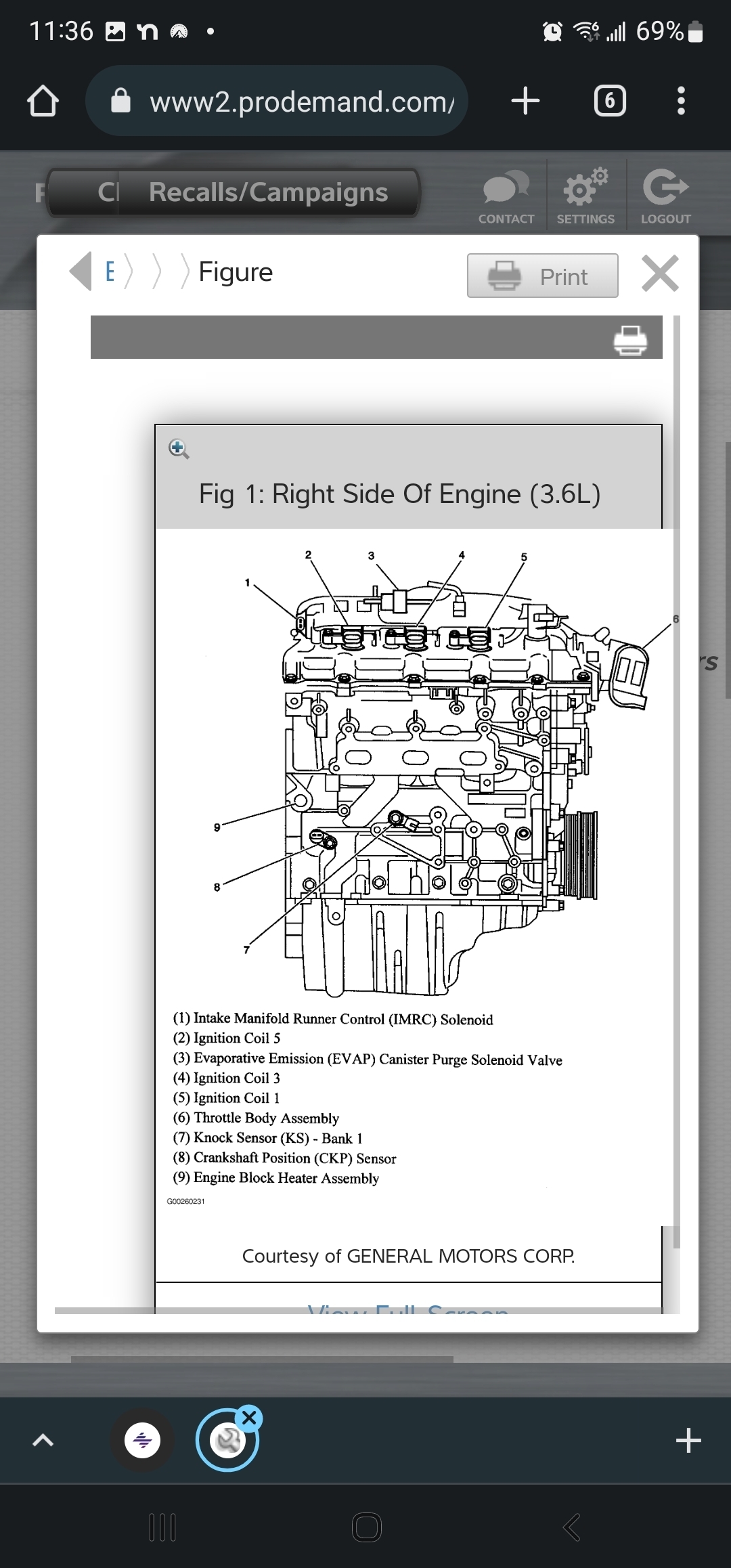

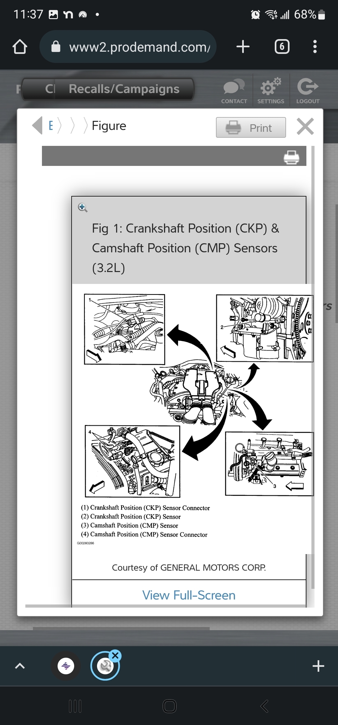

I need to know the location of the crankshaft position sensor. There is no info on the internet about the location of this sensor. Hopefully you can help me with this.
Nov 12, 2022 at 8:57 AM
SATURNTECH9
  • 30,869 POSTS
I put all three scenarios for you since you didn't list the engine size. Let me know if you need any more assistance.
