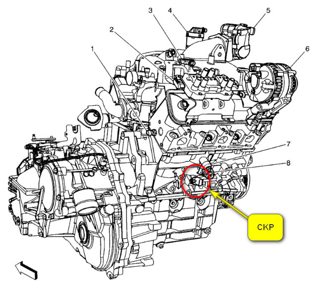

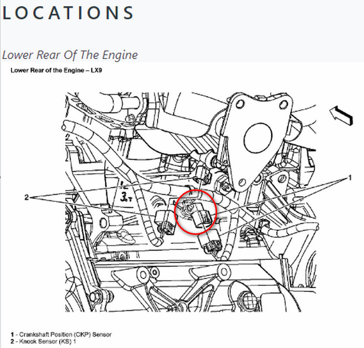

Location of the crankshaft position sensor.
May 18, 2023 at 11:24 AM
BORIS K
  • 836 POSTS
The crankshaft position sensor is located on the right side of the block towards the rear.
See image 1+4

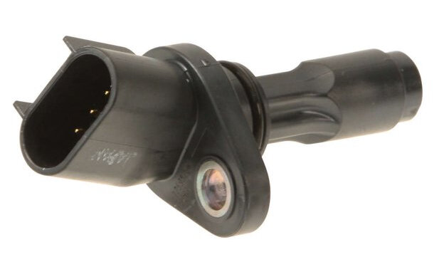

CRANKSHAFT POSITION (CKP) SENSOR REPLACEMENT
REMOVAL PROCEDURE
1.Raise and support the vehicle. Refer to Vehicle Lifting.
2.Disconnect the crankshaft position (CKP) sensor electrical connector.
3.Remove the CKP sensor bolt.
4.Remove the CKP sensor.
5.Inspect for wear, cracks, or leakage if the sensor is not being replaced.
INSTALLATION PROCEDURE
1.Lubricate the O-ring with clean engine oil before installation and replace the O-ring if necessary.
2.Install the CKP sensor.
3.Install the CKP sensor bolt.
NOTE: Refer to Fastener Notice in Service Precautions.
Tighten the bolt to 11 N.m (97 lb in).
4.Connect the CKP sensor electrical connector.
5.Lower the vehicle.

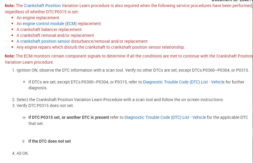

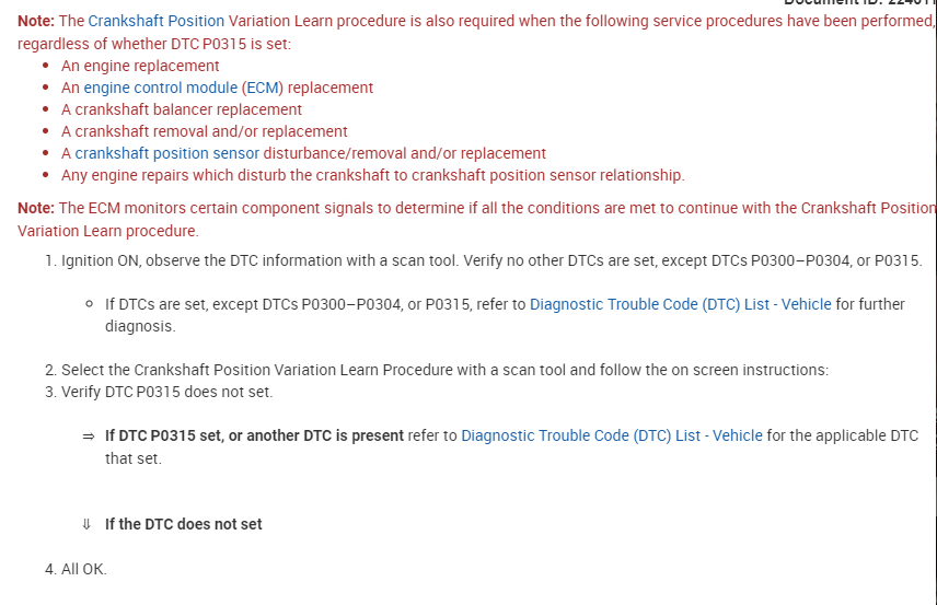

6.Perform the CKP system variation learn procedure. Refer to CKP System Variation Learn Procedure.
The CKP variation learn must be performed using a suitable diagnostic tool. See image 3
