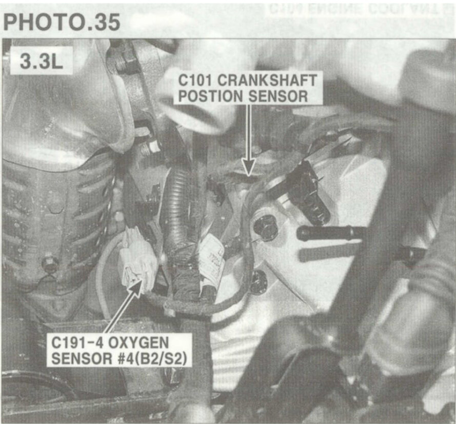

I'm having trouble locating the position of the sensor. I only find answers for the 2.7l not the 3.3.

Hi there. The CKP sensor is located in the transaxle bellhousing toward the front of the vehicle. Sorry for the image quality. I hope this helps. Check out the images (below). Let us know if you need anything else.
