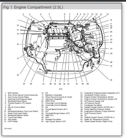

Where exactly is the crankshaft position sensor located on the vehicle listed above ES model?

Hello my name is Dave.
The crankshaft sensor is located in the bell housing on your car, I have attached a diagram showing you the location. Hopefully this will help you out. Thanks for using 2CarPros
