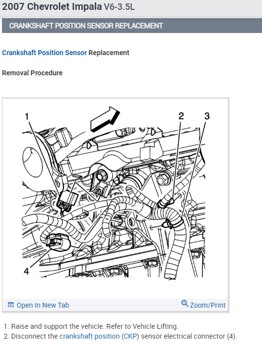

How to remove crankshaft position sensor?
2007 CHEVROLET IMPALA
150 MILES • 3.5L • V6 • MANUAL
GAMBINO
crankshaft position sensor removal.
Nov 16, 2021 at 8:50 AM
SQM
  • 6,383 POSTS

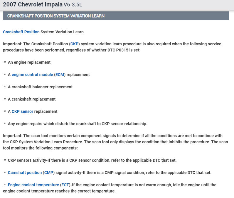

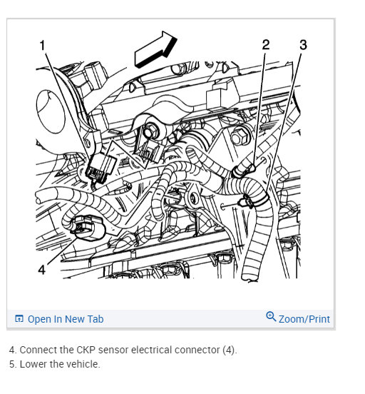

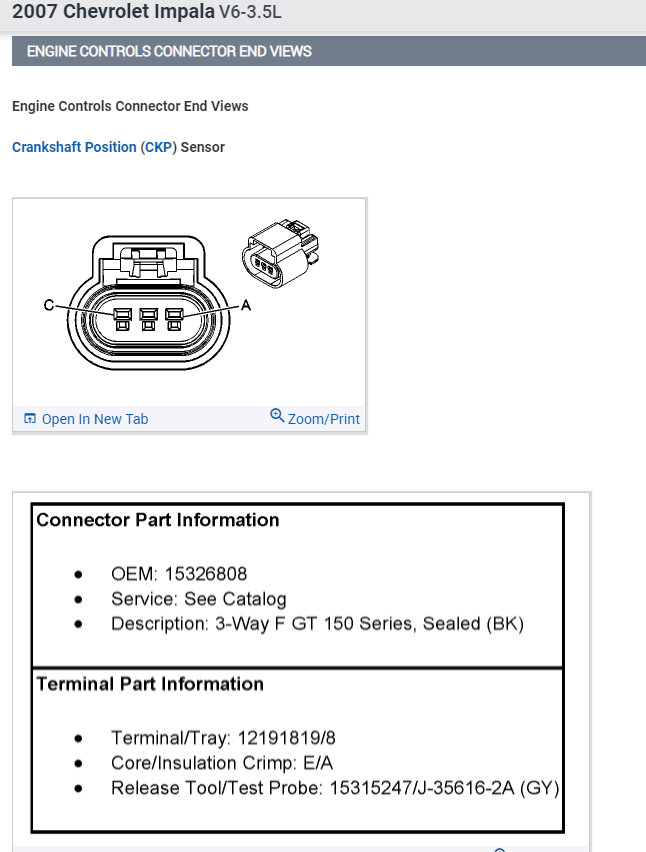

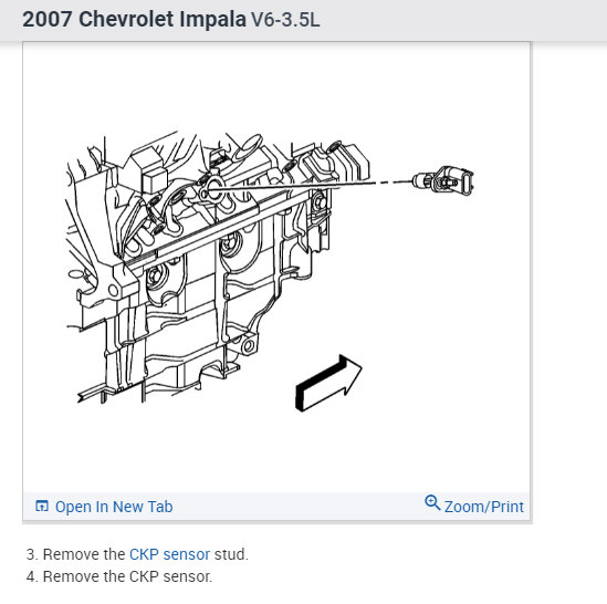

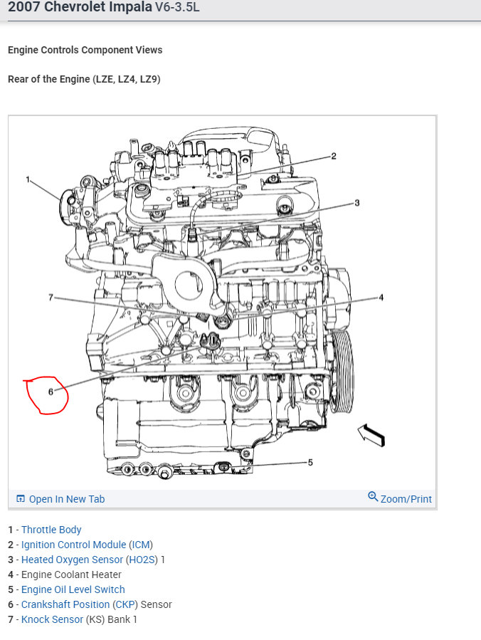

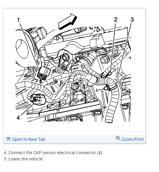

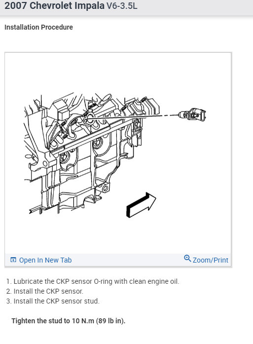

I have attached the crank position sensor replacement instructions below.

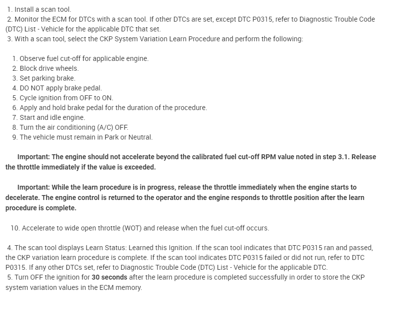

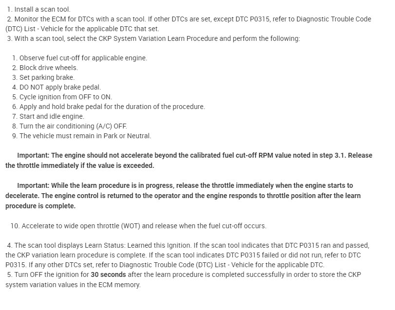

Keep in mind that the new sensor needs to be programmed to the car in order for it to work properly. Which will require a programming capable scan tool. I have attached the programing procedures as well.
